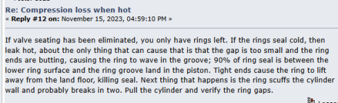

Just found an interesting explanation for compression falling when hot, from a moto guzzi forum:
OP had similar symptoms as me, too small ring gap did end up being the problem after he reopened the top end and remeasured.
I mentioned before my ring gaps measured .016" new out of the box, I really want to remeasure that now.
Interesting, not something I'd considered since most rebuilds are with OEM oversizes and proper work by the machinist who does the boring and clearance so it shouldn't happen. Now if someone used the next oversize rings (.010" bigger) and hand-filed them, then it could easily be a problem if left with too tight an end gap.
This could potentially tie into the upside-down ring theory as well, which could interfere with the oil film protecting the cylinder wall and contribute to overheating. Too much heat might also cause the ring gap to close.

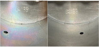

Rechecked the ring gap on L piston rings, in spec, so tight ring gap theory is out. Weird thing is top ring doesn't have a letter stamped on it, middle ring does. Same on R piston rings. I remember there being stamps on the top rings, and the pic on 4into1's site shows stamps. Think the stamps must've worn off or something. Unfortunately I lost track of which way was facing up on the L top ring and since theres no stamp now Idk which way to put it back on. The top and bottom sides of the ring look identical, is there a way to know which way is up without a stamp?
EDIT - looking again at the 4into1 pic the top rings indeed do not have stamps so I guess the orientation didn't matter.
Cylinders look fine, did leak test on valves they're sealing perfect.
Maybe I'm looking at the wrong set, but this is a line from the description of the ring sets on 4-into-1:
4-into-1: Make sure the Letter stamped on the top two rings are facing up when installing them and stagger the ring gaps according to the manual.
When I look at the picture of their ring set, there are two rings shown at each side, each with a capital R on them. The three-piece oil ring is laid out in the center triangular grouping.
I actually have two sets of the 4-into-1 rings that were not needed for my build. I *think* they are standard. The boxes show 13011-391-004. I'd be happy to mail them to you, if you'd like to start fresh rather than gamble on the ring orientation.
you're right, I was mistaking the oil rings for the top rings in the pic. Well thats weird, I swear the markings must've worn off then.
Thanks for that offer, I was thinking of finding some OEM rings this time, I'll let you know.
I was just looking at some OEM rings for my CB360 and I can see how the second ring in that kit matches the profile shown in the image I posted earlier. The 4-into-1 second rings don't seem to have that same profile. I was checking for the marking on the OEM top ring and as best as I can tell it is a small 0 on the kit I have.
It looks like CMSNL has OEM ($$) and non-OEM ($) rings. Send a PM if you'd like the free 4-into-1 rings from my leftovers.
think I figured out which way is up judging by wear marks on the edges of the rings. theres a little bit of wear on the lower half of the edge on all the rings. makes sense from what I read the lower edge of the ring is pushed outward against the cylinder wall on the power stroke which creates the seal.
