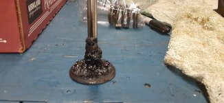

Well that's ugly. I've been telling people for years that excessive valve clearances can lead to this, but that is far worse than usual. I'm sure you won't mind if I borrow that picture to use as a worst-case scenario example for others in the future.Top of a valve![]()
Ofcourse, people might learn from it. Btw, the issue was visible from 5 out of 8.Well that's ugly. I've been telling people for years that excessive valve clearances can lead to this, but that is far worse than usual. I'm sure you won't mind if I borrow that picture to use as a worst-case scenario example for others in the future.
I've never seen that type of damage to a valve tip before. It's painful to see!

it was the first time of my life that I had to use the Dremel to remove the mushroom at the top before I was able to remove them
