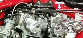

Does anyone have a picture of where the install point is for the Y junction?
Honda typically went down the opposite side of the frame for most cables, clutch across to the right side of the steering head and back across to the left under the tank and the throttle across the left side of the steering head. You can go either way as long as it doesn't cause any issues with stop to stop handlebar turns. Since I have Mikunis on my 450 I had to modify a lower half of the throttle cable from a slide carb Honda and it was a bit short, so I ran mine like this. Not fond of the look but I've been to lazy to bother changing it because it works.
That makes sense. I was trying to do the separate side of the top tube thing but it got messy and weird with fully locked out turns.

Stage one of the cowl that will house the speedometer, neutral light, headlight controls and day/night auxiliary lights (might as well have some fun with micro LED’s)
Since fiberglass is one of those 3-4 hours between layers projects and the whole thing is hand-shaped, It’s been a fun time. Just about have it there - little skim coat of Bondo to smooth, some more dust creation and it’ll be ready to go off to paint with the tank and headlight brackets (although these still need another layer - had some real fun with this one trying to make the bar clamps and scrap metal bracket look a little more respectable. Fiberglass really doesn’t like 90 degree angles in small spaces. trust me. It’ll look better eventually.
During drying and non-dust creation times, I pulled the engine out and rerouted that generator wiring I had done wrong, and noticed that the polish on the block was totally discoloring. I’ve shined more than my fair share of aluminum and this has to
be some kind of chemical reaction - I just have to figure out how to strip it and start again - any ideas on this black discoloration? It’s only the block. Just odd.
