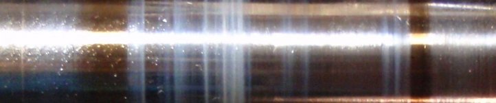

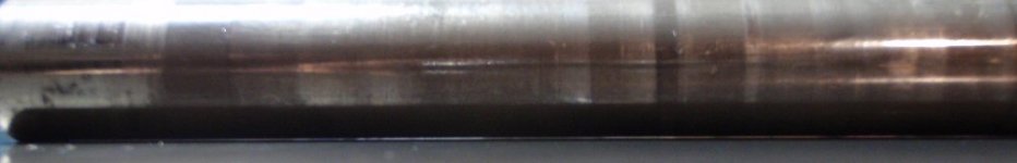

The chrome on the rockers was gone, some parts broke out and damaged the camshaft lobs. The middle of the camshaft lobs was much thinner then the outside, so some rockers where also damaged because of that. The bearings of the camshaft - head where good, also the bearing surfaces in the head itself, so the head can be re-used, the camshaft not. Luckily I tracked down a new camshaft, so that problem is solved for now.
damaged rocker
damaged rocker
Camshaft left side
Camshaft right side
The cam chain was loose, there was no tension on it any more, and I think I stopped riding it just on time.

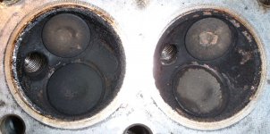

When I took the head off, I found a lot of carbon deposit on the head and piston floors. The valves where not really burned, not one of them. I was very happy I was able to pull the head and cylinder without any damage, all studs are in perfect condition, as the bolts and nuts. The only thing I have to do is re-plate (sink), saving a lot of hassle and money. In the past I bought a few boxes of Honda sohc NOS parts like valves, rockers, cams, cranks, clutches, camshaft bearing parts, but no parts numbers on it. I have found at least 7 camshafts, but all larger, probably CB500/CB550 and CB750. But after comparing the valves, I found all the valves and rockers I needed (I replace all valves, all rockers and all springs).
combustion chamber 1 and 2
combustion chamber 3 and 4
I removed the valves, and cleaned the head. Afterwards I beat blasted the combustion chambers and in and exhaust ports with the finest bead I could find. I use a very low pressure while blasting. The result is a very fine structure, and the bead also closes the surface. I made pictures of all the ports and inner side of the head.
After measuring the valve guides I decided not to replace them, not one of them was worn out, and all within specifications, and that means saving a lot of trouble.
The combustion cambers are a little rough, but that's the material itself.

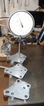

I measured the small rotor sets in the same way and found out that rotor set of pump 3 was the best (0.05 mm), and the play between the outer rotor and oil pump main body number 2 was the best fit (0.05 mm). Non of the rotors where damaged in any way (see picture)
The secondary oil pump cover of oil pump number 2 was really smooth,, so I use that one too (see picture).
So, the complete assembly is consisting of the main rotor set of pump 3, main rotor housing of pump 1, gear / shaft from pump 1, secondary rotor set from pump 3, the main pump housing of pump 2 and cover (and bolts) from pump 2. I also used the pressure relief valve from pump 2, but the spring from pump 1 (stiffer).
The next step is to measure the space between the main rotors side ends and the housing. This space is regulated by the height of the main rotor housing. I used plastigauge. to measure it, and found out that the play was more than 0.2 mm The rotor is made of steel and the housing is made of aluminium, and thus the expansion coefficients differ a lot (steel has a much bigger expansion coefficient then aluminium. From that point the play between rotors and housing can be 0 / +. For safety I choose for 0.02 mm play between the surfaces (20 micrometer). I grinded off the main rotor housing 0.18 mm to make sure not going too far. This resulting in 0.02 mm play between rotor and main rotor housing.
After assembling it turned very smooth and so I now I only had to figure out what size of O-ring to use between the main rotor housing and the main pump housing.
As this O-ring is not mentioned in the parts manual, I did measure depth and diameters (I.D. and O.D.) of the O-ring grove itself. I chose a vitton O-ring that is 25 % bigger in diameter (thickness) then the groove.
Now I only have to assemble the O-ring in the oil pump, and store it for later use when building everything together. From all other parts I made another pump (reserve), in the same way.
The play between the rotors is 0.1 mm, the play between rotor and housing is 0.1 mm, and I refurbished the lobs of the inner rotor a bit with very fine sanding paper. The rest of the parts are for spare (or when I find another good pump or two to go through the same process)
When you look closely to the piston pins you can see that the wear is not linear over the whole area, in fact the piston pins show asymmetrical wear. My assumption is that this is due to an misalignment of the crank in the cases or cylinder to cases, but with this minimal damage on the pins after 100.000 km, it's not something to worry about. The pistons seems to be ok, but measurement shows that the pitons are close to the maximum wear specifications (ovality). The piston ring groove is also showing wear.
Piston skirt
The piston shows a live of blow-by and burned oil area's. However, it's also good to see that the air filter and oil filter did the work they designed for. Almost no vertical stripes on the piston skirt, and that is a good sign.

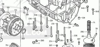

Yesterday I prepared the assembly of the upper- and lower crank case, but unfortunately it seems I'm missing two important bolts. The project was lying around for 12 years, and I cannot find them anywhere. CMS and DSS don't have these bolts. Does anyone has two of those bolts laying around ? P/N is 90086333000, it's a U.B.S. bolt. Without these bolts I cannot proceed with the build. I really would appreciate help in finding those bolts, used or NOS.
I GOT THEM. I made a view phone calls and one of the guys found the bolts and was happy to part with them. Next week I can finally close the cases after 12 years !
In my search for the missing bolts for the past two days, I stumbled onto a box I could not remember having it, nor what would be in it.... Opening the box showed a lot of NOS CB450 and CB77 parts. Pistons, rings, bearings and a complete set of CB450 K0 camshafts.
No bolts for a CB400F '75 :sad:
