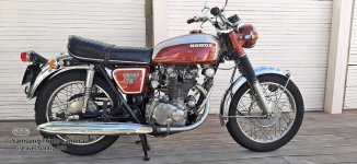

CB125 K5 '76 - 1st weekend.
That starter cable worries me. It carries the live feed from the solenoid to the starter motor, not protected by the main fuse. Only live when the starter button is pressed, but potential there for problems if the insulation was damaged as a result of incorrect routing. It should be held in clips under the engine, then routed up behind the engine through the hole in the frame provided for this purpose. Probably an engine out job to do this correctly.
.. I see. Not simple. This may be a job for later. I am still thinking about whether I will keep it and restore the bike properly - ie, strip it down and rebuild - in which case this particular task will be addressed. Or I live with it for now and I just tuck it out of the way and just use the kickstarter. I still feel like I'm assessing the whole project right now.
I came to the conclusion that the starter motor is not working because I tried it with this cable attached and nothing happened. The solenoid clicked. I have power at the end of the cable, when i press the starter button - so this suggests the starter needs attention - either a rebuild or replace - I haven't got that far yet.
Beat me to it, like the 17 and 200 engines, there should be a retaining clip to keep those wires away from the sprocket. Easy enough to fabricate something.
I have removed sprocket cover to check this. I do not have any hole or any mounting point to fix this clip. The only possible way is the slot with casting rib just under the cover. Surprising ...

Progress Report.
Been a bit too hot here in Southern France to do much. Laid off the tire fitting to the local moto garage.
New tires. Mitas H03's.
Cleaned wheels. Trying them on for size. I think they look cool.
Brakes cleaned up - new shoes.
Swingarm ok. Did a bit of rust repair in a couple of small spots on the frame.
Was thinking of ordering a chain and sprocket kit - but to be honest they don't look too bad after a cleanup.
I like the way she looks with the front mudguard off. A bit fierce.
Looks brilliant, like a new bike.
Mitas HO3s. I fitted those to my CL175, thinking that the semi block pattern suited the look of the bike. I never really gelled with them, always felt that I was falling off the edge of the tyre when leant over in a bend. Probably just me though, a contributor to Classic Motorcycle Mechanics liked them. I'm happier with a more rounded profile and softer rubber.
The only downside to removing the front mudguard (apart from the engine getting dirtier) is that you lose some structural integrity on the front suspension. That brace point keeps the forks more in sync.
I was just trying them on for size. The mudguard will going back on.
You can always just use a fork brace if you want to keep the open wheel look. There are some aftermarket ones out there, or take the simpler route of just cutting the fender brace out of an old one.
