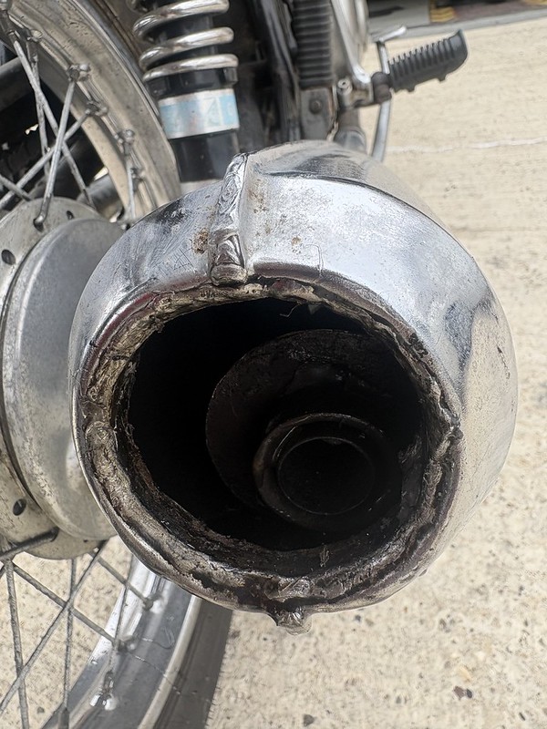

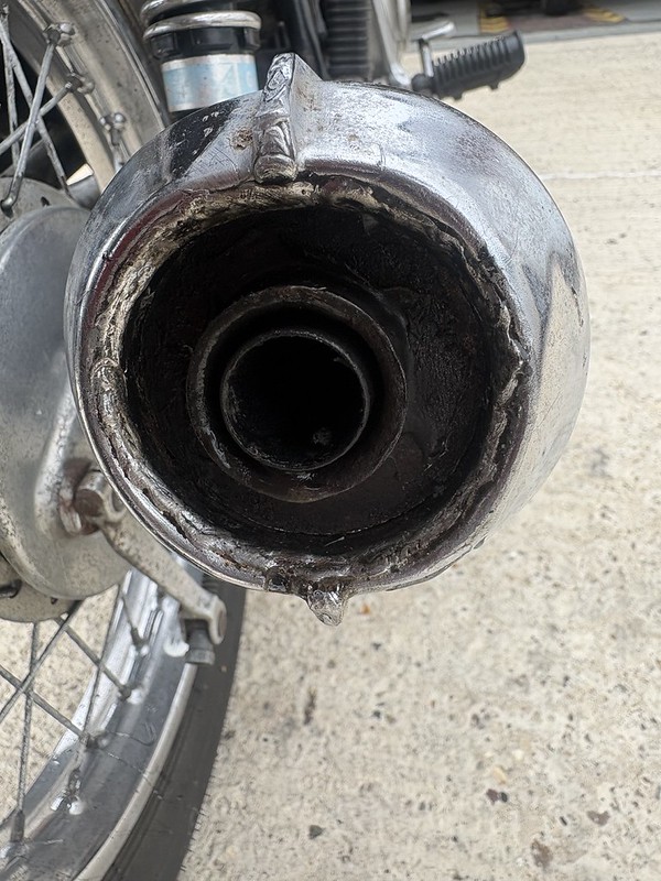

Nice, very unusual for seat cover to be original and quite unusual for silencers to still be good, even with only 21,000 miles.
The lead in petrol back then caused corrosion, guts rotted out after a few years

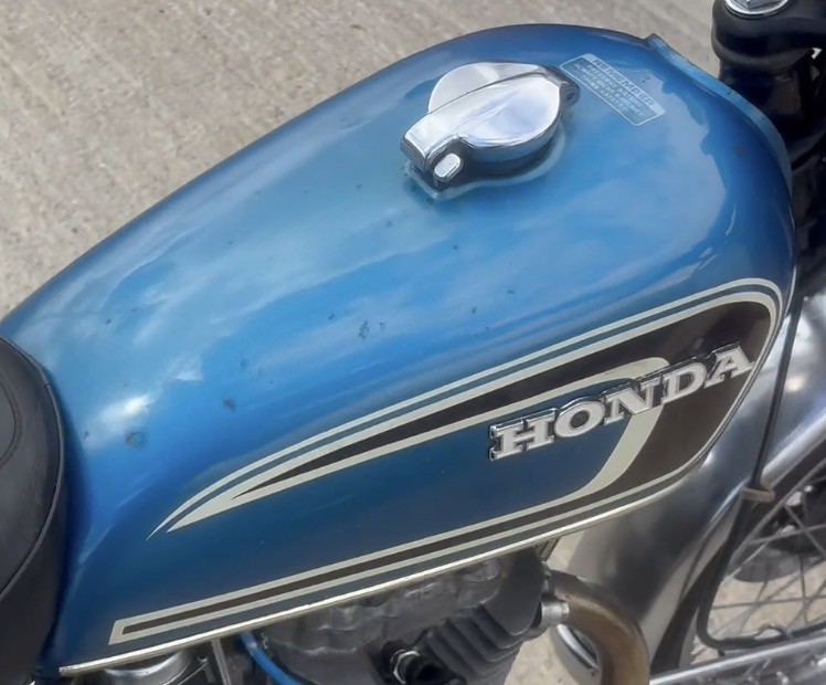

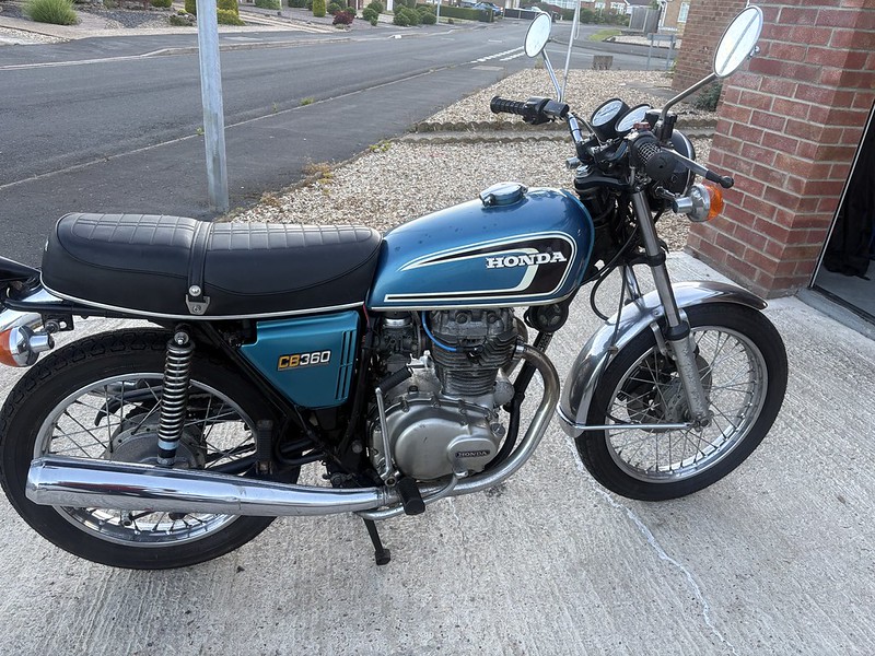

Gosh, there is a lot in there. Thank you, let’s see if I can answer it all in one go:
1. I think I’ve discovered the solution to the silencers’ longevity: there are tiny drain holes close to the front and at the bottom on each. I use the same trick on my Volvo Amazon to drain excess water from the rear (coolest) box of the exhaust where it otherwise tends to condense and rot from the inside. I think a PO must have drilled them early on the the CB360’s life because both silencers are in very good condition.
2. It is normally UV light that degrades seat fabric on motorcycles (if not physical rips). I don’t know, but that suggests the motorcycle has been garaged for its life.
3. That is an interesting story about the keys - but does explain why I have two identical sets of keys And not one single key.
4. I have changed the whole of the clutch actuation mechanism - all 4 parts (if I recall about £60 from DSS), including the #10 size ball bearing. It works absolutely fine now.
5. I fixed the old clutch cable by lubricating it properly (I bought a little gizmo from Amazon for a fiver that allows me to squirt aerosol under pressure until it reaches the other end), so I’ve re-fitted that. The after market clutch cable inner I got was about 20mm too long. I could fit it, but there would be no adjustment left at either end if the cable. I found a solder on nipple exactly the right size in my spares shed. In the fullness of time (when I’ve got the soldering kit out) my plan is to cut 20mm off and solder the new nipple in the right place. In the meantime the cable (and nipple) can reside in my spares shed.
6. What is an ‘oil transfer piece mod’?
7. Yes, I use 10W40 - same stuff as I had left over from the Gold Wing I sold earlier this year.
Thank you so much for taking an interest. A link to the information on point #6 above would be much appreciated.
Those drain holes are likely from the factory, all Honda mufflers had water drain holes at low points underneath in an attempt to help with longevity though they were easily clogged over the years and of course, became non-functional once blocked.

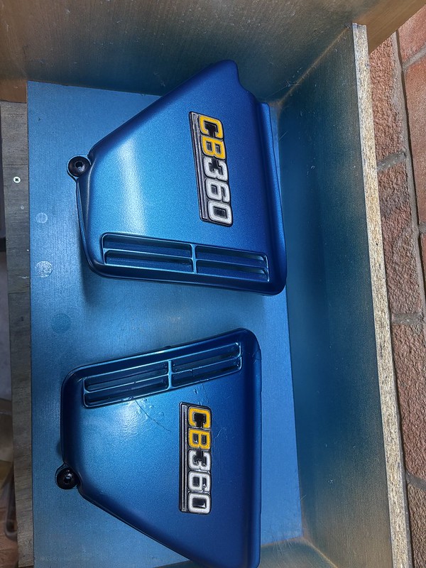

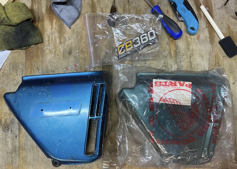

Regular readers will know that I’m not restoring the CB360 - just making it a nice motorcycle I can use, it is however let down a bit by the right side panel, which is quite damaged and has lost a few bits here and there (the photo is quite kind to it - in the flesh it is quite poor). A few days ago I noticed a NOS part on eBay; £38 later it was on its way to me by mail, and it arrived today:
IMG_0655 by Alan Othen, on Flickr
… it is green, rather than blue, so I’ll get it painted, the badge fitted and on the bike. It will make me happy :)
I don't know, Alan, you're rapidly approaching the point of no return. =)
Nice pick-up, I'm looking forward to seeing how the painter does with it.
… it is so difficult to prevent mission creep. Yesterday evening I found myself wondering whether it might be worth stripping the tank and getting it painted - but then of course it be looking for a left side panel - and then perhaps some new rims and spokes - and of course I might as well just strip the frame bare to have it powder coated. Fortunately I came to my senses and we are back to just changing the one side panel to make the bike nice :cool:
I do think I was a little fortunate in finding a NOS side panel - I imagine this one has been sitting on someone’s garage shelf since they bought it for their green Honda in about 1985… the bike that was sold in 1989 :).
Alan

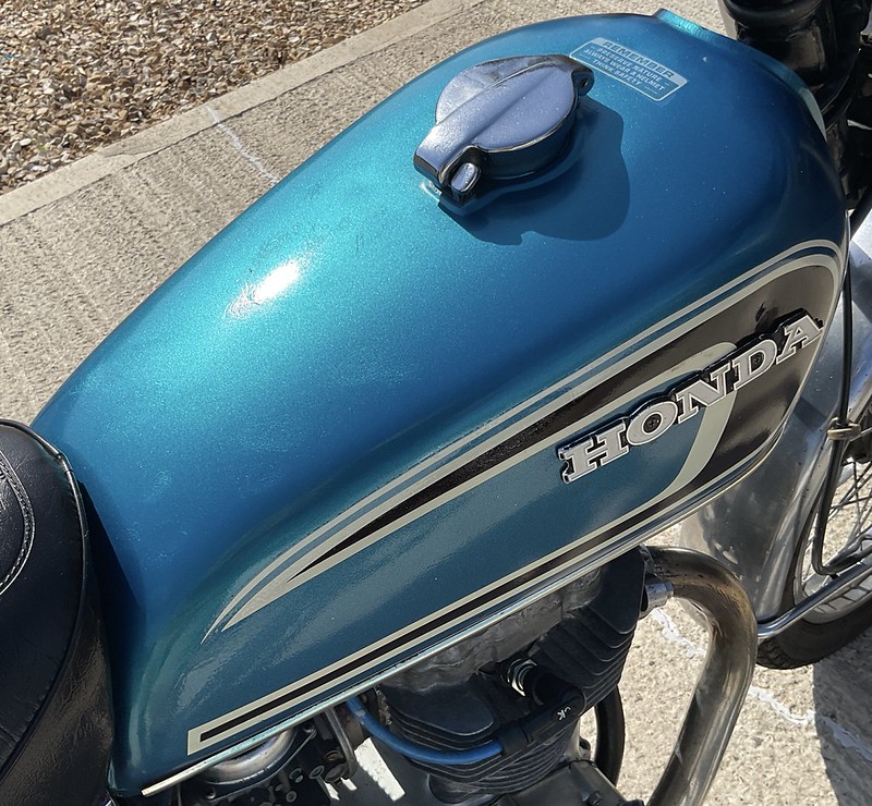

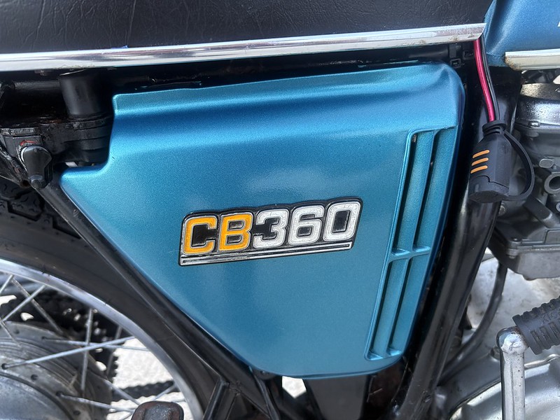

I've been having a go with the paint. I bought 4 petrol tanks and i've got 3 decent side panels, and 1 with a broken off grill piece.
I've been trying to do pinstripes. I'm not doing a restoration of my 1975 CB250G5, more making something that I like the look of.
This is the first attempt with the panels after the lacquer but before the cutting compound and polish

The painter turned out to be me; I’d ordered a mixed aerosol to Honda recipe PB-5C-S for less than £20 and had a go at making my green side panel into a candy riviera blue special one. I’d carefully taken off the badges and rubber bungs, and previously repaired the left side panel from the back, so I gave both covers 4 coats of paint plus two of clear lacquer. I’m really happy with them:
IMG_6734 by Alan Othen, on Flickr
… and they look very good on the motorcycle, the new one:
IMG_6739 by Alan Othen, on Flickr
… and the repaired one; not quite so good but very much better than it was yesterday:
IMG_6738 by Alan Othen, on Flickr
The CB360 is much tidier now:
IMG_6735 by Alan Othen, on Flickr
A good day :)

Before and after…
I had half a tin of aerosol colour left over from painting the side covers, plus some primer, lacquer etc in the spares shed, so yesterday I thought I’d try to improve the 360’s tank. It had a few dents, plus perhaps 20 scratches and chips on the top side - I suppose from 50 years of jacket zippers and so on:
IMG_0669 by Alan Othen, on Flickr
… this isn’t a restoration, so I decided not to tackle the 2 dents (neither of which was particularly bad). I just focussed on the central blue area - scrubbed all the chips and scratches down to the metal (some had attracted a little rust) with some Emery pads on a battery multitool, cleaned everything thoroughly with IPA and carefully masked up to the white lines (still on the motorcycle).
The central blue area got a coat of primer, 3 of colour and two lacquer. I also took the badges off for a clean in IPA and lacquered underneath whilst they were removed. I think the result was okay:
IMG_0670 by Alan Othen, on Flickr
No cost, a couple of hours of my time (mostly waiting between coats), allowed to harden over night and it is much better than it was. I think that was time well spent, and the result is entirely in keeping with the ethos of the motorcycle.

I had set aside today as a motorbikin’ day, and chosen the CB360 for a good run out. I’d done about 50 miles in rural Lincolnshire A roads, and through Boston heading roughly west towards Northamptonshire. The 360 hadn’t missed a beat and was huge fun, then suddenly the exhaust note changed, becoming much deeper, within a mile or so the exhaust got louder and the top end performance clearly dropped off. It was a sparcely inhabited area, so I continued on to Market Deeping before pulling off the highway to see what was wrong.
The problem was instantly obvious: the baffle in the right hand silencer (muffler) had separated from the outer body and was rattling around inside the otherwise open megaphone:
IMG_6891 by Alan Othen, on Flickr
I managed to find a builder’s merchants that sold me some 2 part epoxy adhesive/filler, so I tried a temporary repair. I spent an hour or so on that, mostly waiting for the adhesive to cure. It worked perfectly… for about 5 miles! The megaphone exhaust returned, I had a choice between waiting for the AA (Automobile Association) recovery truck or nursing the noisy motorcycle home 50 miles. I decided to coax the bike home, keeping to small throttle openings and 4,000 RPM made riding tolerable. I felt a little like a Lancaster bomber pilot nursing a stricken aircraft back from wartime Germany with one dead engine… 2 hours later the 360 and I arrived home safely.
I’ve just had a look at the broken baffle, the weld has broken all the way round at the back of the silencer, so it is still rattling around inside. It appears to be complete, and using some grips I can pull it back into the right position and orientation:
IMG_6893 by Alan Othen, on Flickr
… but of course it won’t stay there as soon as the pressure, vibration and heat from the exhaust get to it.
How do I fix this? Now, I think I could probably MIG weld all around where the baffle joins the body (although it would be fiddly), but I’m thinking the metal is probably really thin and corroded after 5 decades of being immersed in hot exhaust gasses, so it may not work for long. Also I wonder whether the right hand silencer is much the same inside (they seem to be the originals) and so may not be far from a similar failure?
Would a welded repair be feasible, or should I be looking for replacements? I don’t think it would be worth fitting secondhand silencers - they would probably be just as bad inside, and original Honda parts aren’t available, so that leaves pattern parts. I’ve found a UK manufactured replacement that looks right and is for the right model (G5):
Pattern 360 silencers
… the cost is about £350 (a bit over $400)/pair, which isn’t so bad I suppose. The original silencers have probably done quite well in lasting 50 years, although it does seem a pity to replace them with non-originals, but if I do, I think it worth changing them as a pair.
What do people think? Is it worth attempting a welded repair, or do these silencers always fail there, and so need replacing? Is there a better aftermarket solution than the pattern parts I’ve posted the link to above?

Internal rust caused by the actions of exhaust, heat and then sitting for sometime later is the reason for the thin metal resulting in what happened to you. The challenge of welding older mufflers is always the rust as well as the thin remaining metal, so those pattern replacements would seem to be the better way to go. And those look decent too.
Thank you for that - it confirms my thoughts. Even if I succeeded in achieving a gas tight welded joint I rather suspect I’d end up stranded somewhere when the thin 50 year old metal fails in another place.
I‘ll go for an aftermarket replacement, probably the ones I posted the link to as they do look quite like the originals.
