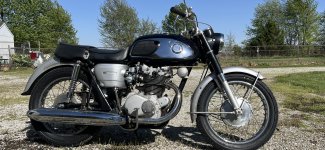

I will suggest putting the bike back as close to stock with brand new fresh air filters and the correct size of jet whether it is 125 or 130? If you have both and stock is 125 then use that one first. Change those plugs for new, as they are no good now with all that crap on the porcelain. You can clean them and they will work, yet likely soot up easier now since they have been contaminated.
For testing purposes maybe the cleaned plugs will suffice, yet once you get it sorted then put in brand new ones.
All the grungy filters and larger jets are a probably a contributing factor. Plus todays gas formulation is much different than stuff 50 years ago. If anything it can be leaner with the ethanol, yet your not getting that response from the bike.
