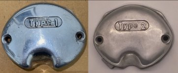

The engine in this bike is a Type 1 180 degree engine with the "whack a mole" pistons. I don't have an open picture of the Type 2 but you can see the difference here.
I was going to pontificate about "why this firing order over another" but know that a far better explaination sits with much smarter people than I so follow this link to a gent well worth a listen too. In this case he discusses the various differences in vertical twin firing orders which encompasses the Honda Type I and Type 2 by default. His presentations are such that even this cave man gets it. And besides this video, he has many engine related videos you will enjoy, I promise.
Straightened some fins, cleaned 'er on up. OK, lets admit it is cleaner but the backgrounds affect the shine here too.
