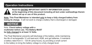

My old charger was a straight ½-Amp NAPA charger, always on when connected. Loaned it out and it has not been returned, so I got one from HF and another from O'Reilly's.
The HF unit charges at ½-Amp, but is microprocessor controlled for battery maintenance. It's so smart that it won't charge a battery that has less than 12 V. This cost only $10, so it'll go in the garage for maintenance duty.
I then bought another charger from O'Reilly's so I can charge a battery that actually needs to be charged. That one seems to produce 0.8 Amps and, if it has a minimum voltage level for operation, it is much more reasonable. I couldn't find any mention of it in the instructions.
