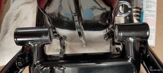

It's the original frame and swing arm.
I am having trouble mounting the swingarm.
I had the frame and swing arm powder coated and they painted over the mated surfaces. I sanded all 4 faces down and the swingarm will still not slip over, it's close.
Honda has tight tolerances.
Has anyone had this issue? Any suggestions?
THX
It looks like the issue is caused by powder cost over the old bushings. Is that what I'm seeing there?
Agreed, and I'm also wondering if the originals might have slightly melted (they're often some kind of phenolic resin that can melt if the temp is high enough), so the outer edges could also be slightly misshapen.
