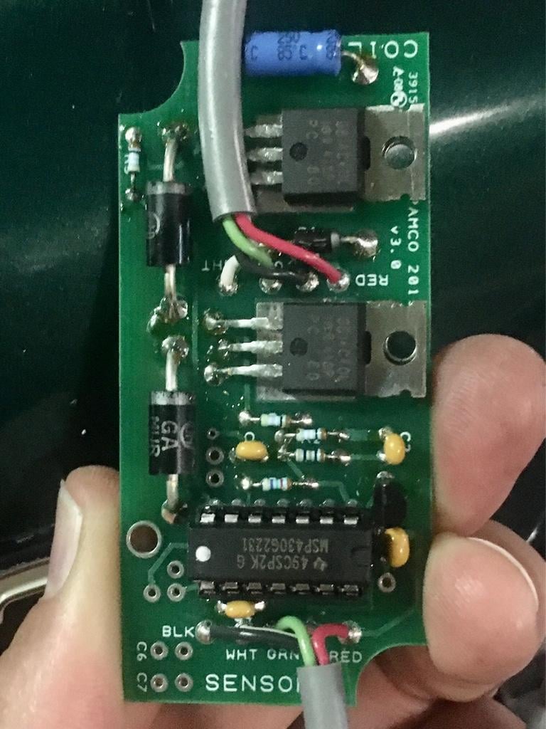

I’ll pretend I know what those things are and go google a diagram.
These are hall effect sensors (red) and the blue box is the e-advancer

Take a look at under the e-advancer board and see if you have any burned connections or solder joints.
I’ve found a guy local who can diagnose and potentially fix the unit. His speciality is Printed Circuit Boards (PCB’s) and although he’s never seen one of these before he was comfortable taking a look just on the photo I sent him. He’s also had a comb through some Pamco threads he found online to get an idea of what it does. Seems like a possible solution depending on cost.
if he has the tools and equipment to test the board and components it should be fairly easy to fix I think.
The parts aren't anything specific to Pamco so I think you should be able to source them or compatible repacements.

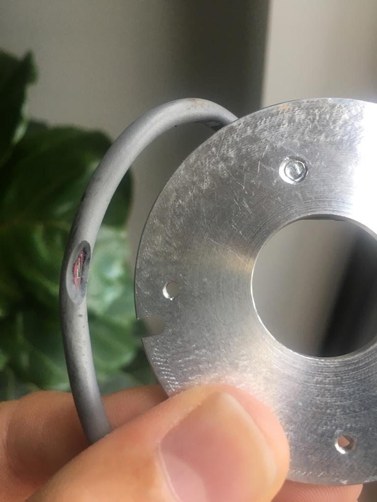

So I’ve found the problem!
I did not see this until just now.
I’ll still take the unit to the electronics guy because my soldering is not good enough to replace that wire anyway.
There may still be hope, unless that grounded bare wire caused something to fry. Good luck with it.
Yeah best to take it to someone with the right equipment and skill to fix that. Those wires are tiny and I mean tiny. Fat fingers can botch that repair job and makes it worse.
Even if there are parts that are fried. You should still be able to replace them easy enough.
This is the ONLY part of that board that cannot be replaced since it requires programming. This is essentially the brain (microcontroller) of the electronic advance.

Can’t believe I missed the break in the wiring! I was so focused on the board and the pickup sensors.
That's why I said to do a continuity test early on. Just because the wiring looked fine on the outside doesn't mean there isn't a break somewhere inside the sleeves.
A continuity test with a multimeter would confirm.
