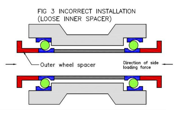

I tightened the front axle nut to 40 ft lbs and noticed the wheel did not spin freely under its own weight. I can turn the wheel by hand. I loosened the nut and then the wheel rotates easily.
I stuck a finger inside to feel the bearings. I didn't feel any play in the bearings. I noticed behind the left bearings there is something like a spacer that has a slight bit of movement. Looking at the FSM, there is a distance collar.
I wondered if whoever pressed the bearings didn't press them all the way down?
Can I try tapping them in more? Is there a size of socket that works out well for that? Do I need to remove and replace the dust covers? Do you tap from both sides or just one? The FSM looks like the wheel is just resting on a couple of boards. If I do that can I avoid taking the brake rotor off?
