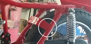

The work began to make better, stronger rear fender mounts and beef up the rear area of the frame since the original channel-style forward rear fender mount had been removed. Since it was a PITA for my buddy Mike to bring his MIG welder 70 miles up to my garage, I took the frame down to his small shop. Since his place was a one stall rental facility and his hot rod V8 S-10 was on jackstands while he re-worked his 4 link and swapped to a 9" Ford rear end, he literally had no bench room to work on the frame so the work was done in the bed of his truck. ;)

The forward mount was double-gusseted this time, and we added horizontal bracing tubes as well. The rear mount was significantly wider and thicker this time, not taking any further chances for more hindsight.
Checked it for full travel distance as well, since the previous mounting was about 1/4" lower and the rear tire lightly scuffed the underside of the fender on one of our fine rural road pavement imperfections.
Mike would be the first to tell you his welds aren't always a thing of beauty, but I knew I could work on these a bit since there was a lot more meat this time around. Sadly, about 3 weeks after his work on the frame, and on the night before Hurricane Irma screamed north through the state of Florida, Mike had a stroke at age 58. He wasn't found quickly enough for them to do any sort of reversal, and as a result he is now very limited in his speech and has lost the use of his right arm and leg for the most part. His recovery is ongoing and he was fortunate to have been employed by a long-term rehabilitative care facility in building maintenance, so he was taken in and is being housed by by them and everyone there knows him.

With the gusseting adding the strength necessary, I set out to clean it up as much as possible.
The ongoing issue was pits revealed as the welds were cleaned up, and in an effort to get some additional meat added I took the frame to a couple of different places somewhat near me (at the time, I did not know my current machinist or I wouldn't have needed to clean up anything). The first place recommended to me was a pathetic referral - the guy said he couldn't make anything stick to the frame. Then I took it to a longtime friend who builds beautiful custom cars and he stick-welded some beads across the area to hopefully fill things in.
Despite all that extra material to work with, there were still a few little pits revealed once the cleanup was done so I took the frame to the speed shop in Tampa and had the owner's son put some TIG welds on the area as if they were the real welds, and with a light cleanup it was once again ready for powdercoat.
