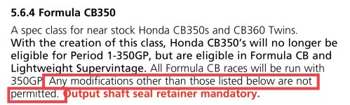

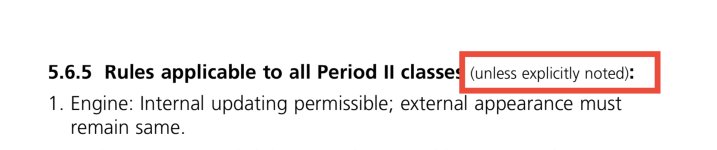

Looks like this pretty broad statement here in the rules would cover the oil mod:
5.6.5 Rules applicable to all Period II classes (unless explicitly noted):
1. Engine: Internal updating permissible; external appearance must remain same.
5.6.4 Formula CB350
A spec class for near stock Honda CB350s and CB360 Twins.
With the creation of this class, Honda CB350’s will no longer be eligible for Period 1-350GP, but are eligible in Formula CB and Lightweight Supervintage. All Formula CB races will be run with 350GP. Any modifications other than those listed below are not permitted. Output shaft seal retainer mandatory.
I believe those are general rules for bikes that run in those period classes. This rule is particular to the Formula CB350 class and states that any mods not listed are prohibited. Like I said, I’m trying to get clarification but nobody responds to my messages.

If you back up inspection 5 it shows that 350 class as P1/2 so both sets of rules apply. The part I cited was in the P2 rules.
Yes, sir, I understand what you are referring to. If you look closely you will see that the general rules apply “unless explicitly noted”.IMG_6049.jpeg
There is a note in the Formula CB350 class rules that clearly states only the modifications listed are allowed.IMG_6050.jpeg
There are other 350cc classes which would fall under the general P2 rules. Formula CB350 is a specific class with its own rules for machine modifications.

Yes, sir, I understand what you are referring to. If you look closely you will see that the general rules apply “unless explicitly noted”.View attachment 36784
There is a note in the Formula CB350 class rules that clearly states only the modifications listed are allowed.View attachment 36785
Yeah. And 5.6.5 is right below that (well, except for the funky layout of the rulebook)

Yeah, the wording is kinda funky, I believe the 26mm restriction is for the Mikuni VM’s. If you have stock carbs you can run them as is.
I’m also intending to at least upgrade to 360 forks so I can run emulators in them. The rules allow 35mm so I could do a swap with a set of CB500 forks but that would gets into geometry changes, possibly spacers to get the hubs to fit correctly, etc. Not sure if I want to dive in that deep but I will definitely consider it.
