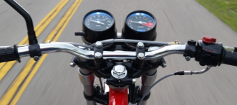

Hey everyone, I'm finally starting to do some cosmetic work on my 1984 Honda CM450E.
Looking to swap out the OEM handlebars with something that looks and feels better than my stock ones. I was reading what some people have done to their bikes and came across this user. I really like the look of the 550f handlebars so I decided that I am going to buy these. I have a few questions though. The user did state that the cables were a bit too long and needed rerouting. I was assuming this was a cable issue, but regardless I was planning on replacing my cables anyways. I wanted to ask, it looks like from the pictures that the CM450 cables, are exactly like the CB550F cables. Now, this might be a stretch but will I still have rerouting problems if I go with these cables? The CM450e cables are very long and I thought the 550f cables would be shorter and suit my bike more? The reason why I am unsure is because these two bikes are almost 10 years apart and Honda may have changed something with the cables during this time. What do you guys think?

I'm not going to say anything beyond this, but take a look at the stock cables on my 450 with the CB400F bars with 1.75" rise. (Ignore the throttle cable, it's shorter than I'd like and I can't route it the way I want to because a gray cable of that type is not easily found)
Hmm doesn’t look too bad, may buy stock CM450E cables instead. Thank you.
