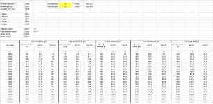

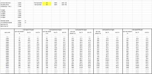

As an engineer, I usually calculated the gear ratio's versus road speeds for the CB450 K0, CB450 K1-K7 and for the CB500T, here you go:
CB450 K0 (calculated with the 33 teeth sprocket instead of the 35 teeth standard sprocket):
CB450 K1-K7 (standard sprocket gear ratio's):

So, as you cab see, 90 mls/hr isn't so bad, but looking at your RPM range you mentioned my guess would be that you were closer to 80 mls/hr @7-7,5 k rpm, as you can see in the second sheet.

btw, I created these sheets to find the optimal secondary ratio (sprocket set). In the original files I can change the value's in the yellow box. Since we have 5 speed-limits (30, 50, 80, 100 and 130 km/hr), it is nice to know at which rpm in which gear these speeds are reached. Usually I also determine the optimal shift pattern in relation to the speed limits.
