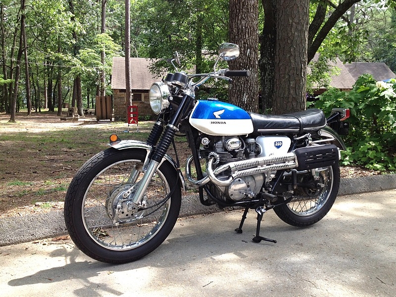

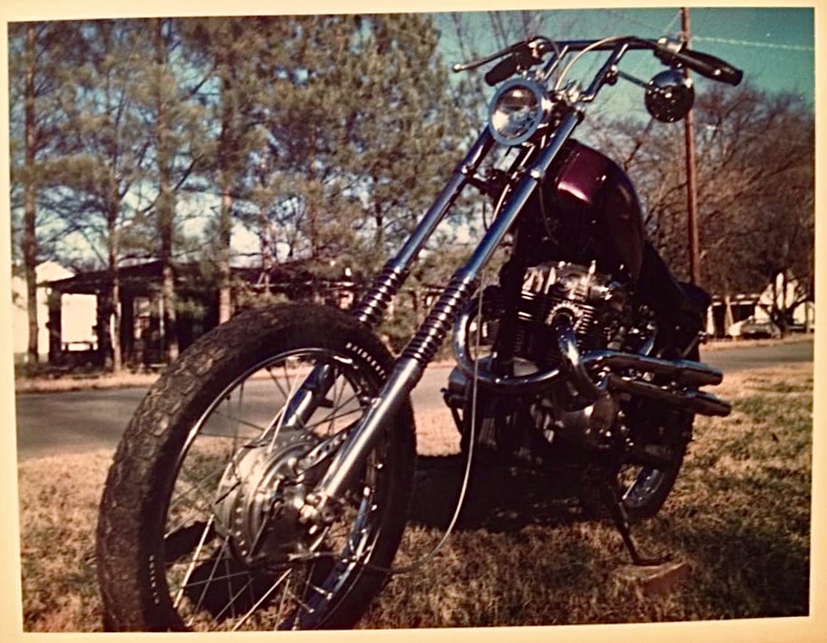

I have a 350 w extended 33mm dia forks and brace. When I carry a passenger, we're over 240lbs and no safety or handling issues.
As a side note, there are lots of 35mm cb450 and 750 extended forks out there and I generally pref the 35mm tubes over the 33mm tubes... but like mentioned above, no issues w my 33mm tube setup.
