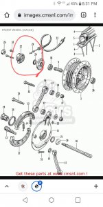

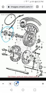

Here's a question. When I was cleaning out the speedometer drive I removed the oil seal and it was long past useable, or even legible unfortunately.
Looking at the parts fiches I find that this bike didn't have a replacement seal available:
I'm wondering if I might be able to use the seal from a CA160 which seems to share no other front wheel parts with a CB or CL160.
I'll go measure the speedometer drive in a little while.
Ok, check my logic please.
CA160 uses 91254-200-000 which when I look it up on eBay has the metric seal dimensions right there on the seal 22 35 8.
Measuring my speedometer drive and the drive flange/bearing retainer on the wheel, it looks to me like I need a metric seal measuring 34 48 8.
Edit: in reply #228 I discovered it's a 7mm seal I need, a 6.5 will work but they're pricey.

After looking at all of the CB & CL 160 speedometer drives on eBay, I conclude that I'm looking for a metric seal measuring 34 48 7
(or 34 48 6.5 but they're pricey)

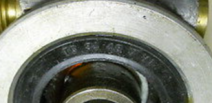

I measured the bore depth as just a hair under 8mm so there are certainly options. Unfortunately lots of these bikes probably got parked when this seal was trashed and let in road dirt to mix with the factory grease like this one did. When this happened the drag on the front wheel was probably noticeable. Speedometer performance probably suffered too.
Honda didnt offer a replacement seal, and I'm sure metric seals weren't very widely available for many years after these bikes were built. They wanted you to buy a whole new drive instead.
If the ID were just under twice the OD, what kind of seal would that make? Let me get my sonic screwdriver out for that one right?
I'll agree that it sure looks that way but the first number is the ID on metric seals.
WELL, That's what the pic indicates, but measuring the center column of the bearing retainer flange that actually bolts to the wheel hub and is notched to drive the speedo gears, the seal-lip is actually for that 34 mm column......
I was making a (bad) joke of how even a pic does not always show the reality of some of the things we deal with here......Sorry....

Honestly I wasn't paying much attention to anything but the seal thickness at that point. After posting the question during the quietest part of the day and coincidentally getting no replies, I posted my inner monologue and finally found the solution.
I didn't mean to poop all over your joke, I'm to blame there. Next round's on me.
