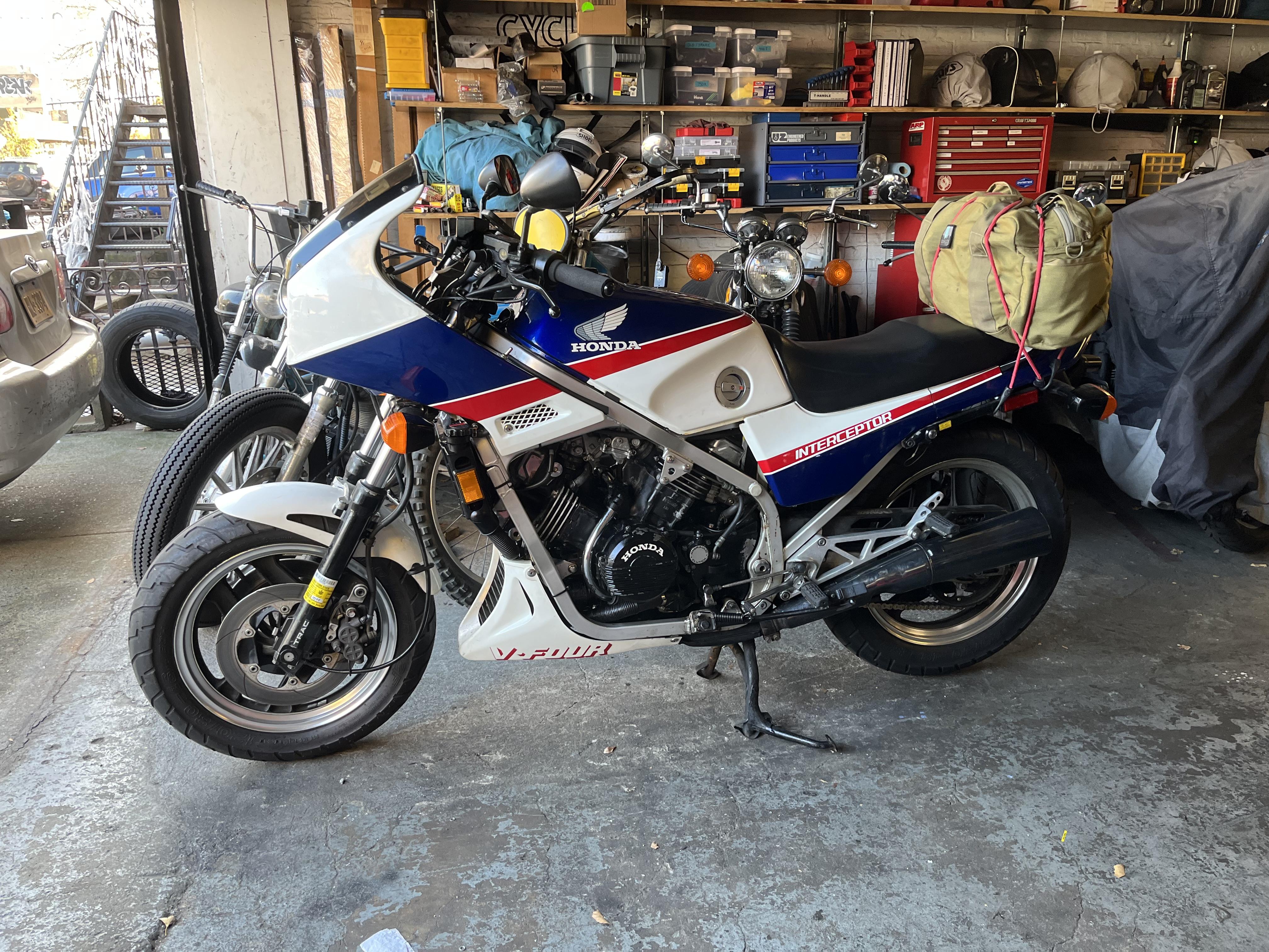

1985 VF700F
It looks like it could be a combined bowl vent to me, but I've never touched any of the V4 carbs. If it is, I'd guess the idea was to keep fuel vapors out of the atmosphere.

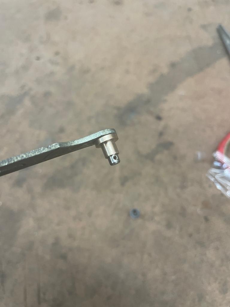

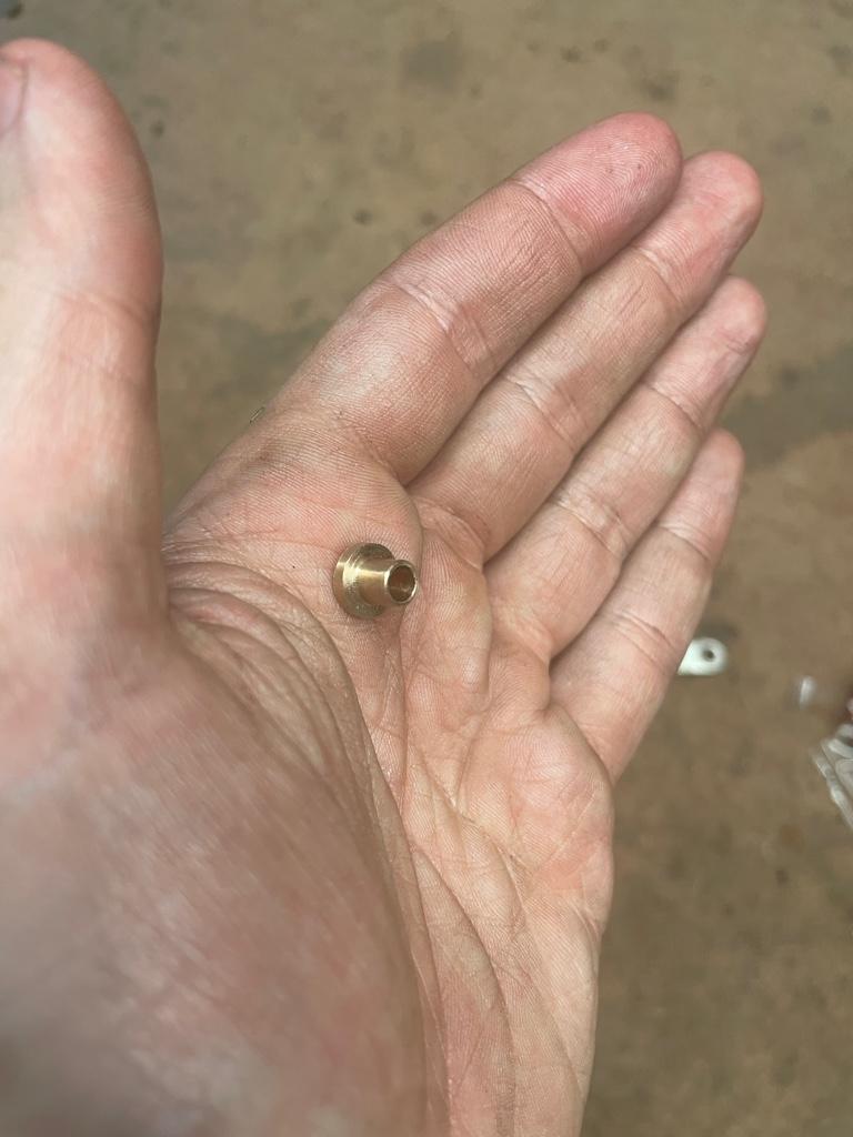

Lost a bushing for the throttle linkage, apparently https://www.nytimes.com/2022/05/12...qM8gzD67zK1OKqZI&referringSource=articleShare here.
Why fret over the unobtanium part when you can make it yourself?

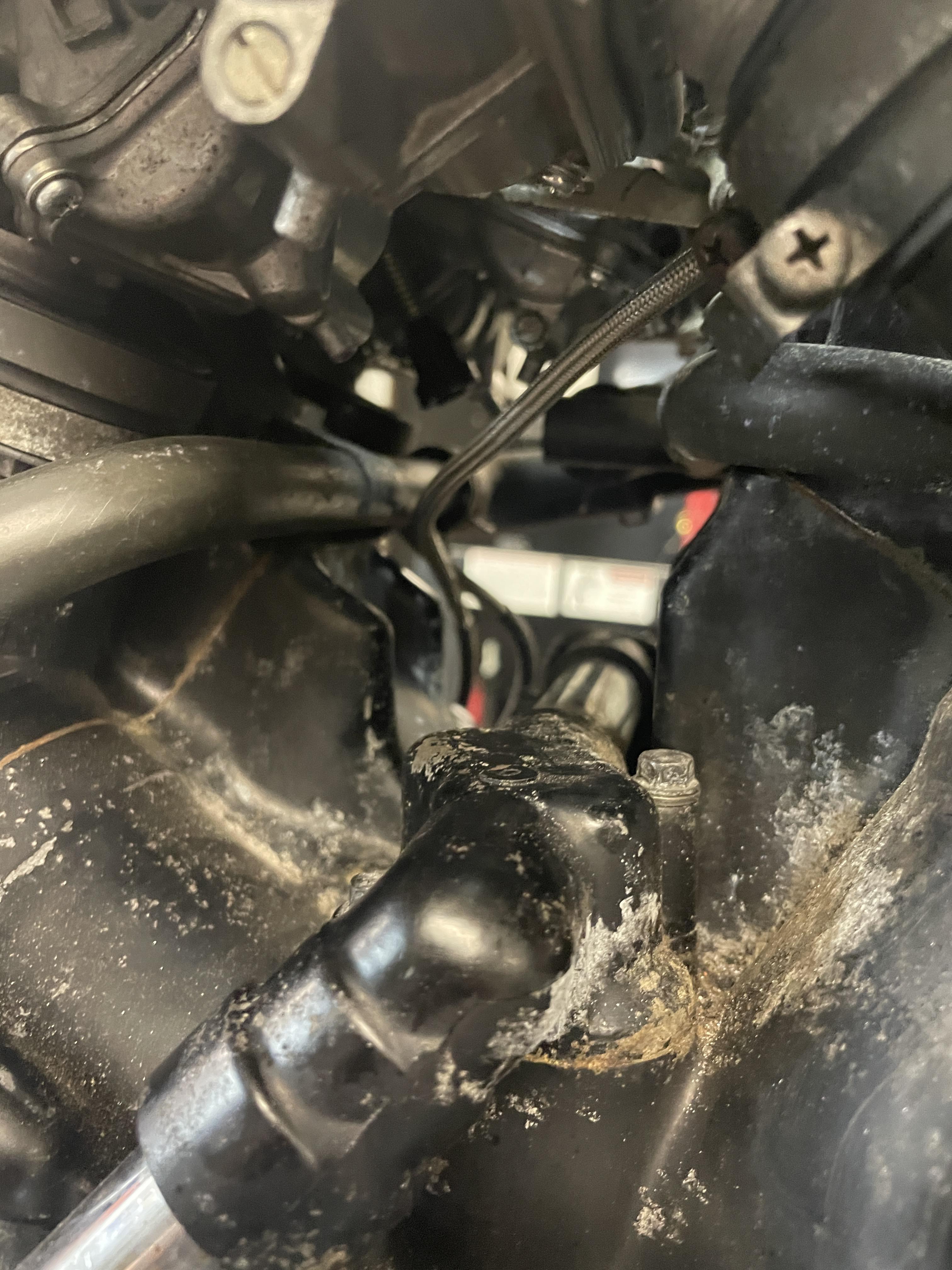

Oh Joy!....You have a California equipped model.... :rolleyes:
Reasonably sure ancientdad is right, and that hose relates to the "Smog" required parts and plumbing.....
My CBR600 engine Hornet has those same vent tubes, open to the atmosphere. I assumed that they were there to equalise the air pressure above the diaphragms in the CV carbs. Strange that no filter is fitted, you'd think that dirt could get drawn in as the CV carb slides dropped.
Loads of other pipes in this pic, disconnected fuel hose, vacuum hose for PAIR system, various coolant hoses, but the hoses in question can be seen at the top of the photo, tee piece with wire clips.
( PAIR system was a sort of smog control, introduced air into the exhaust system on the over run. Swiftly removed on my bike )

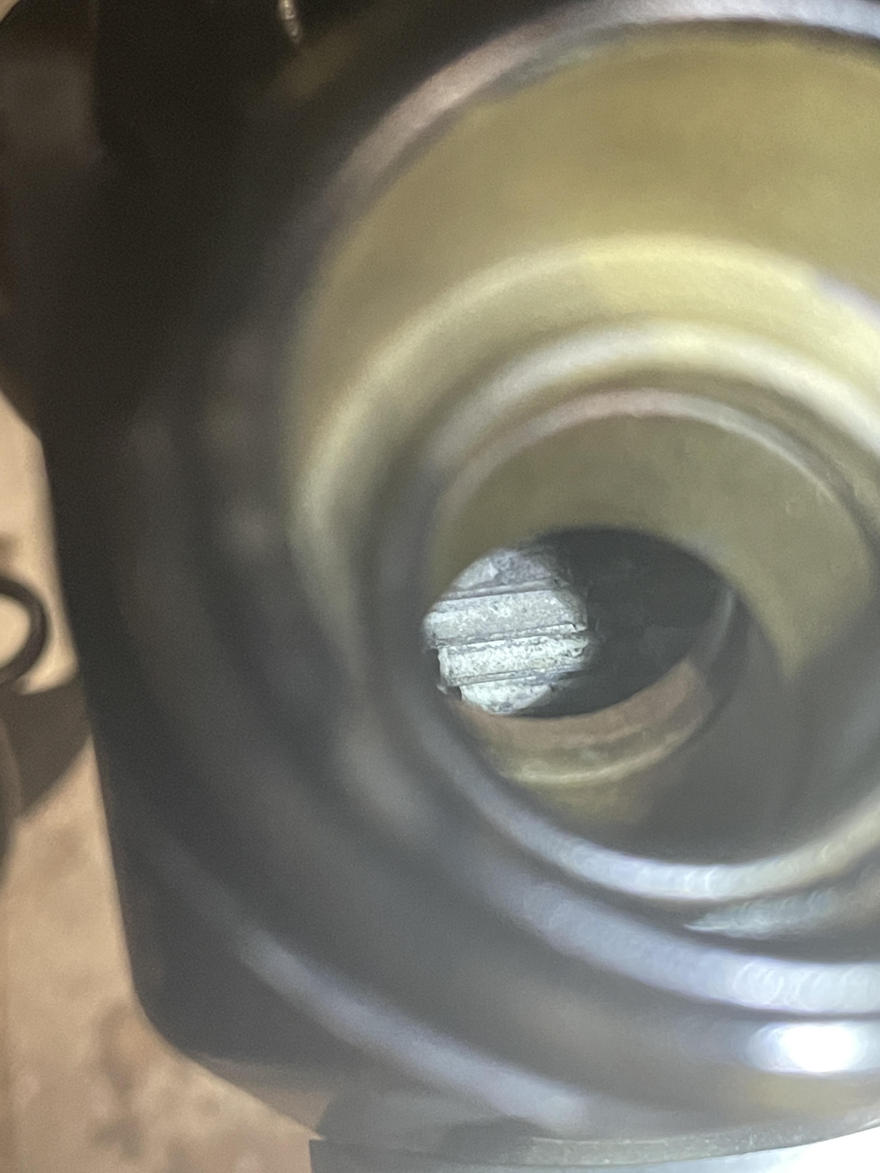

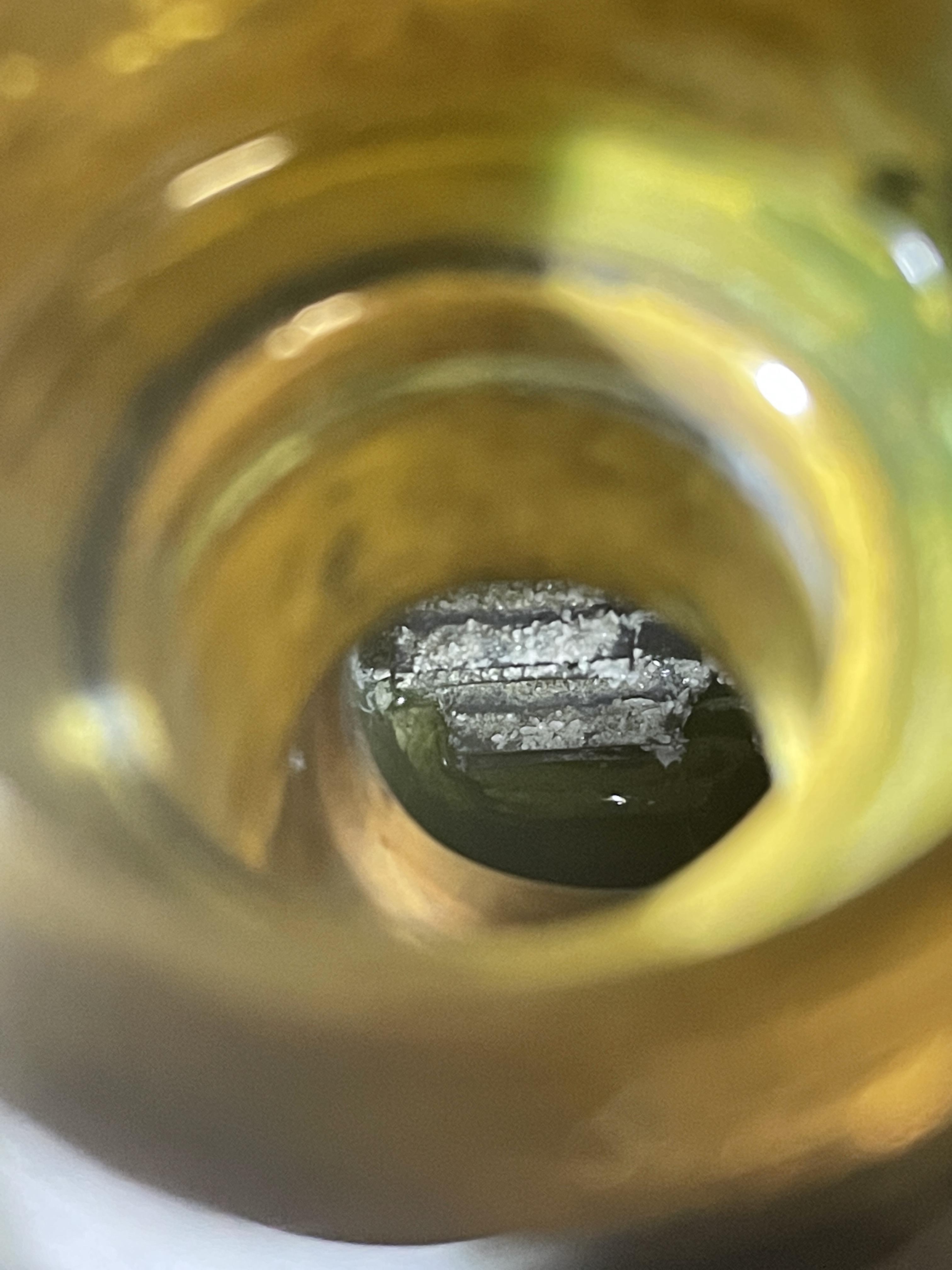

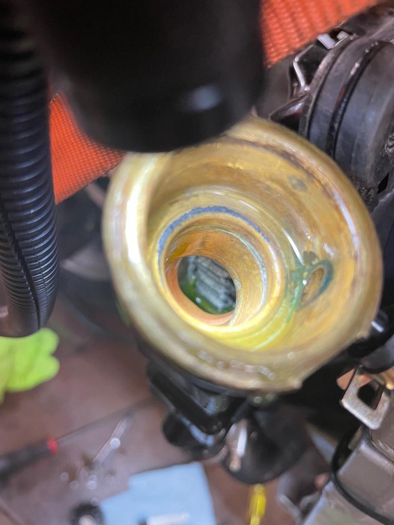

Anyone have thoughts on cleaning buildup out of cooling systems?
CLR and distilled water?
Lots of white buildup in there - can’t believe I haven’t looked.
Can I run it through the engine? Or is there some other way to get rid of the crud that I’m sure is inside the block and head?
Autofocus didn’t pick it up well - but there’s a ton of little white crystals. Makes sense why the engine maintains temp while moving but rockets up when stopped/in traffic.

1985 VF700F
Thanks - that’s about what I was seeing too. I have a bunch of the regular CLR, which I think would be fine for the rads, but it seems like I should be fully flushing this thing.
God knows what else is hiding deep in there.
-Ed
1972 CL350
1985 VF700F
As with any older engine that has had some buildup in it for a while, you have to consider the possibility of thin spots in the radiator and possibly other metal circulation tubing that might have some corrosion-weakened thin spots, like old freeze plugs, that could pop once you use a chemical cleaner. Hopefully the buildup is mostly on the surface and hasn't compromised anything.
This is why I was thinking of going with something softer.
Maybe just baking soda and distilled water.
I’m assuming those white crystals are calcium deposits.
-Ed

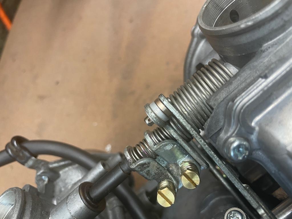

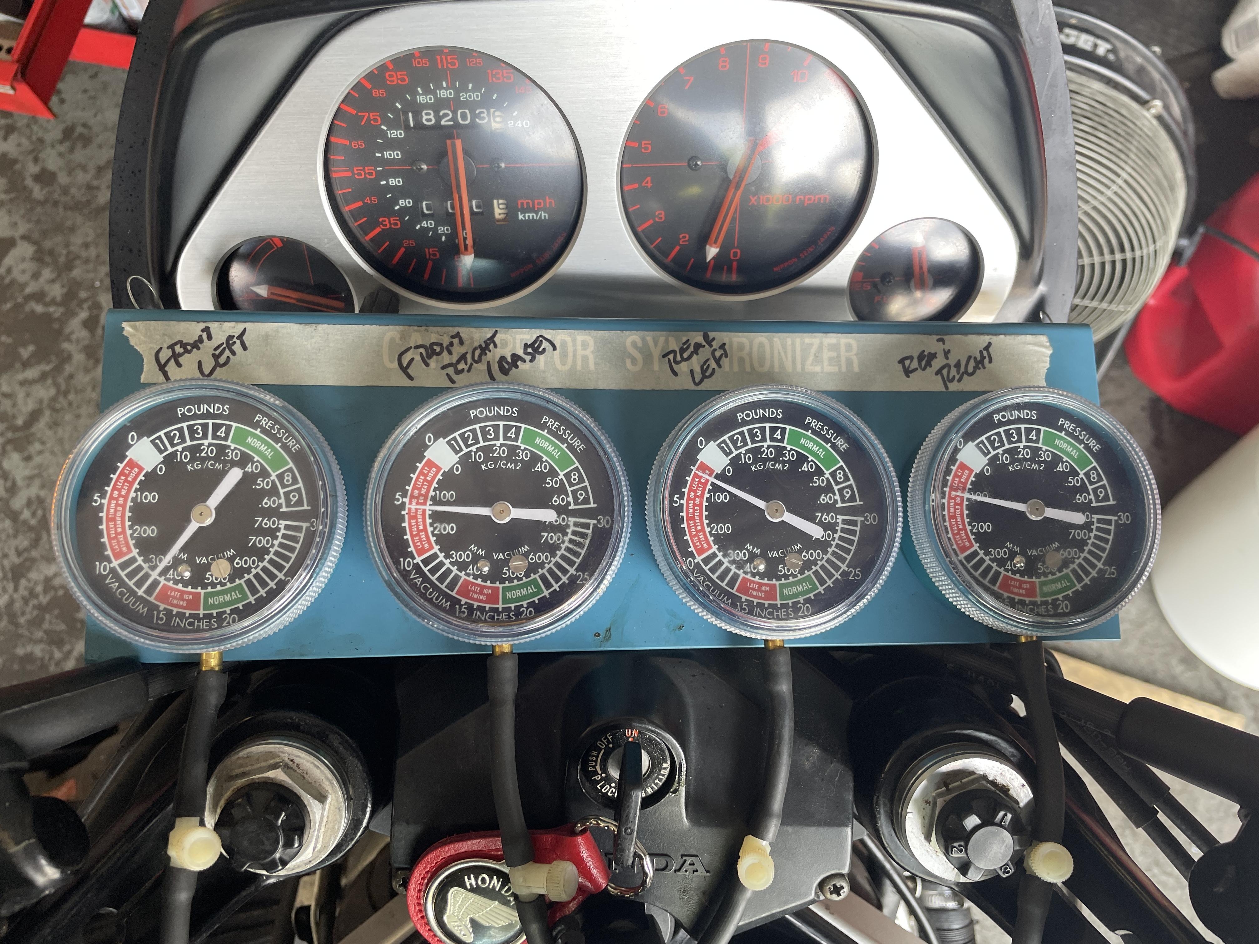

In the mean time - carb synch. Before:
After:
https://vimeo.com/714619060
I feel like I could get it tighter, but I want to wait until I can adjust the pilot screws - I’m going to grab one of those timing lights with a tach.
My non-contact (which Is wildly accurate but requires some reflective tape) won’t work on the flywheel while it’s running on the VF - too much crankcase vapor and oil spewing everywhere use while running.
-Ed

Ugh. I know. I’ve tried finding a way to rotate it on Vimeo to no luck.
If I’m reading the centerline of the needle flutter well enough in about 45mmHg out from the base to the rear right.
Within spec, but not perfect.
Front left is 30mm out and rear left is almost spot on, maybe 5-10 off.
Much more in depth than “stick your hand next the back of each muffler and if they feel the same you’re good [emoji38] “

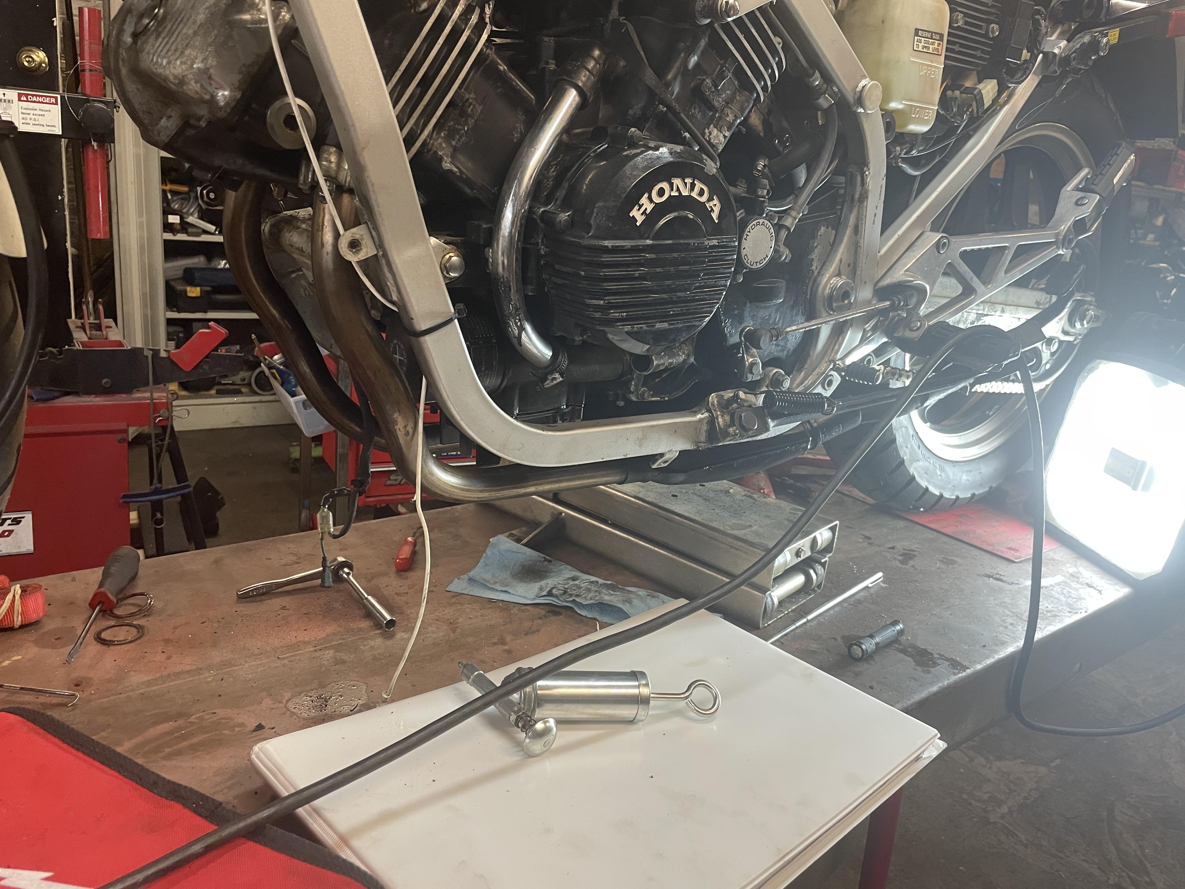

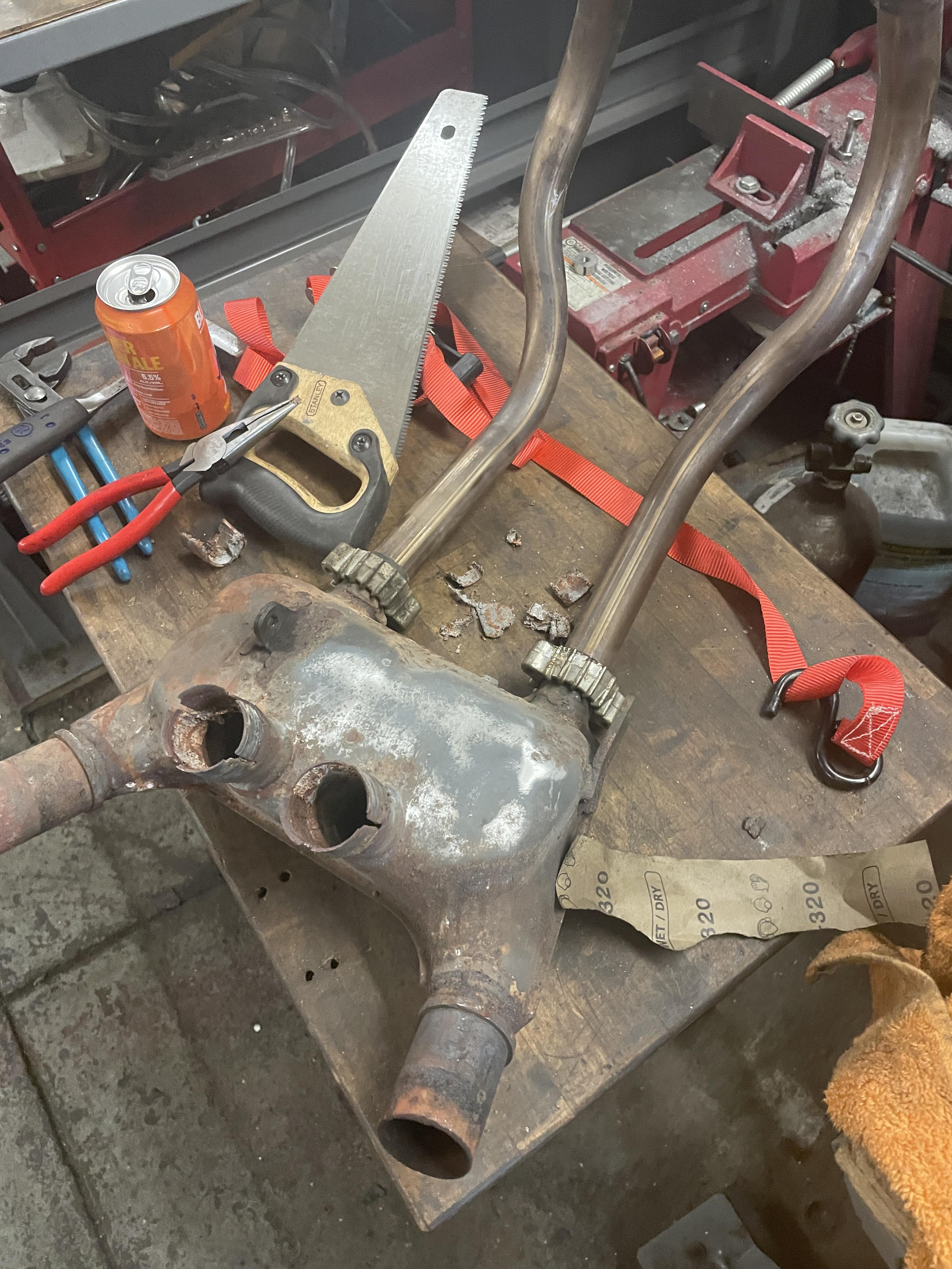

While I’m waiting for the 350’s repair, I had some spare time to hack away at the tasks for the interceptor.

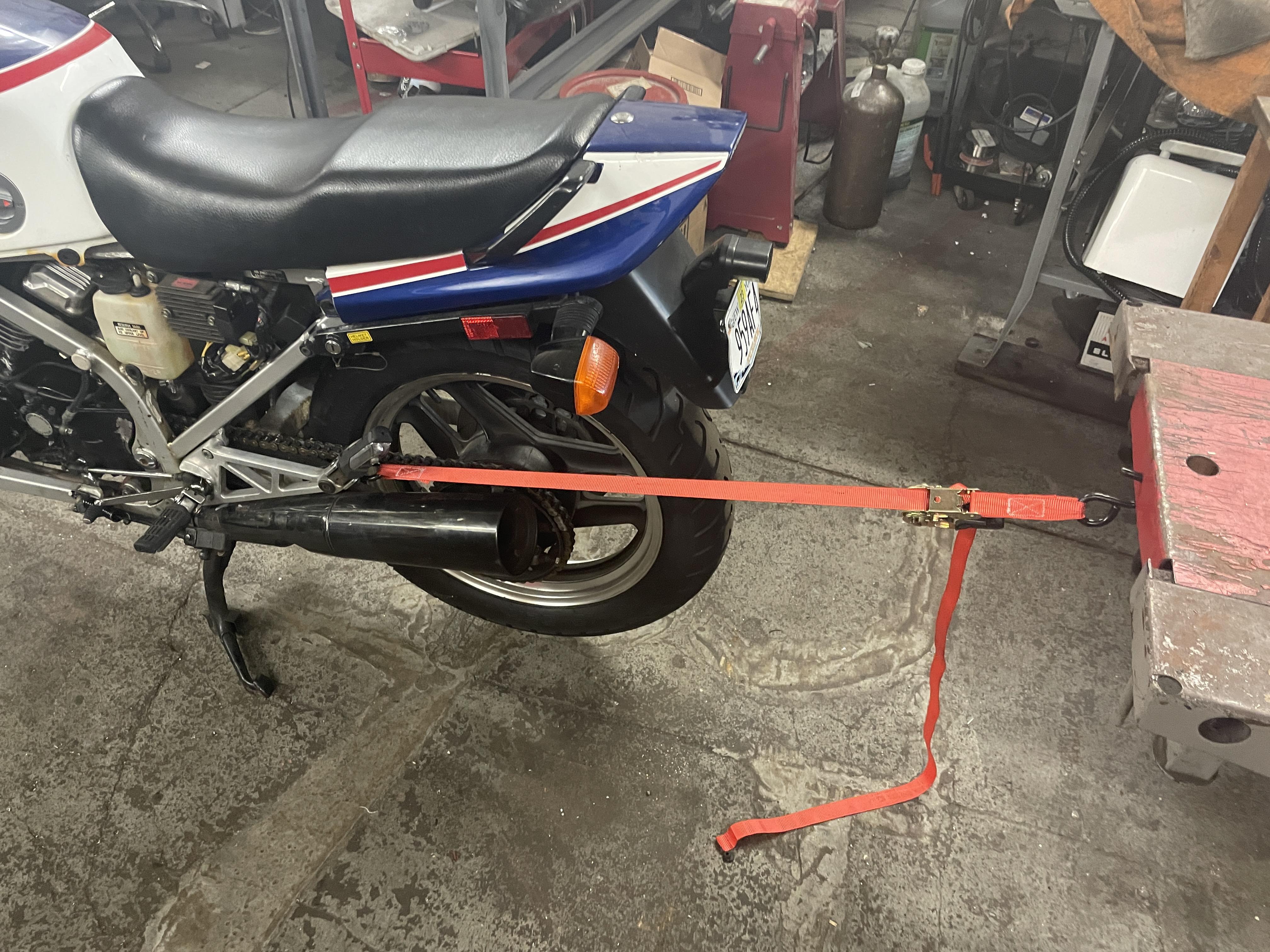

It took about two hours to get the mufflers off - the entire exhaust needs to be removed to get the oil pan off, which I want to spend some time poking around it to look for any debris or signs of trouble.
The mufflers were practically glued on. Had to remove the passenger peg brackets to get more space to work them back and forth and all around until they finally pulled loose.
Originally tried a ratchet strap tied to the exhaust bracket but it would just pull the lift or the bike instead of yanking the muffler back:
This is what the collector looked like after removing the worst of the rust with a wire wheel:
It’s spray painted with some high heat spray paint I had lying around now, and will go right back on after I drop the oil pan and have a look around.
I’ll also be doing the David dodge oil mod to increase the oil flow to the top end, as well as changing the steering bearings and doing some fluids.

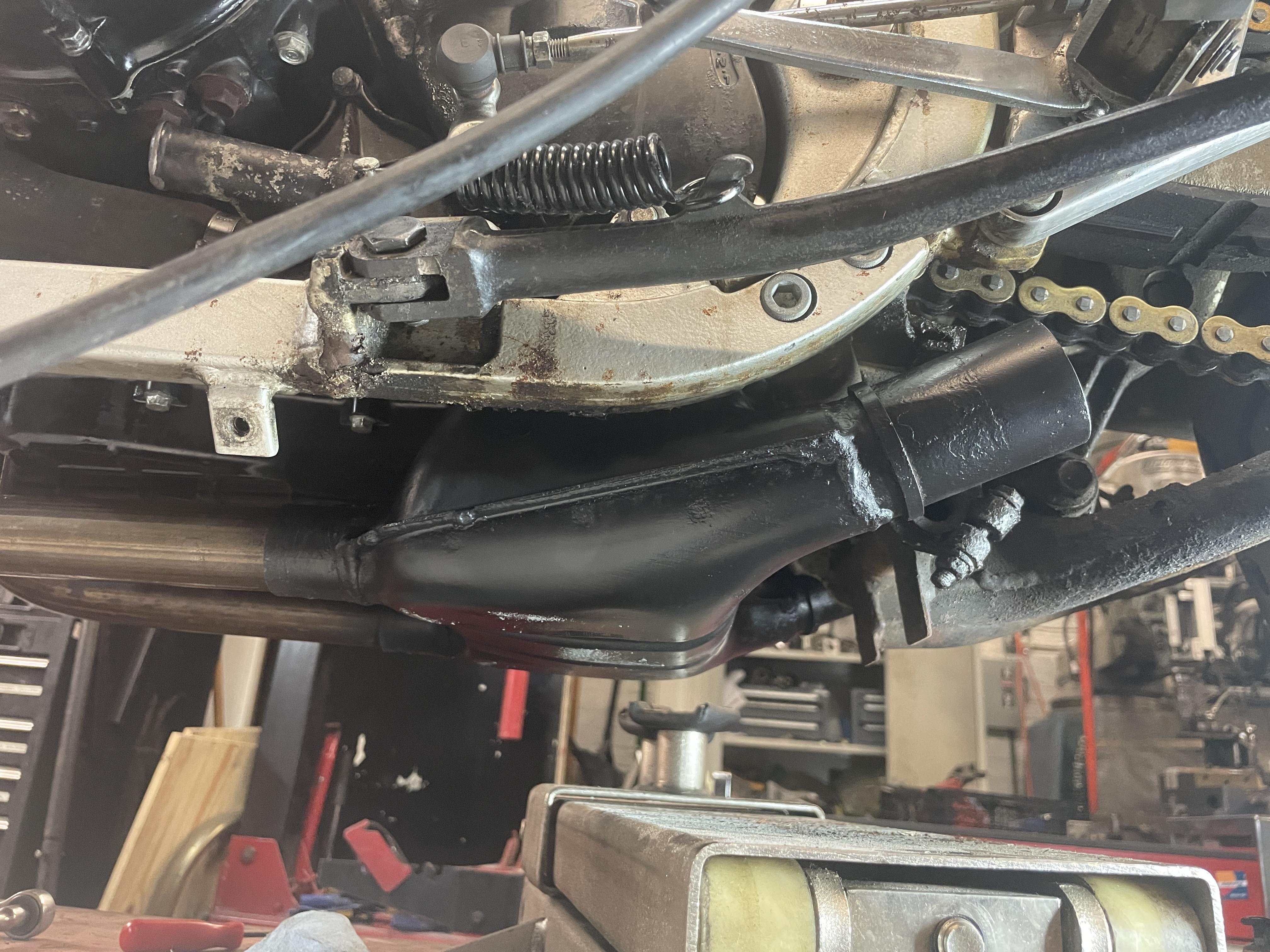

1985 VF700F
I guess every group has the little mods and tricks they've learned to apply over the years since the bikes were built. V-4s, you gotta love them until some parts of them have to be worked on. :eek:

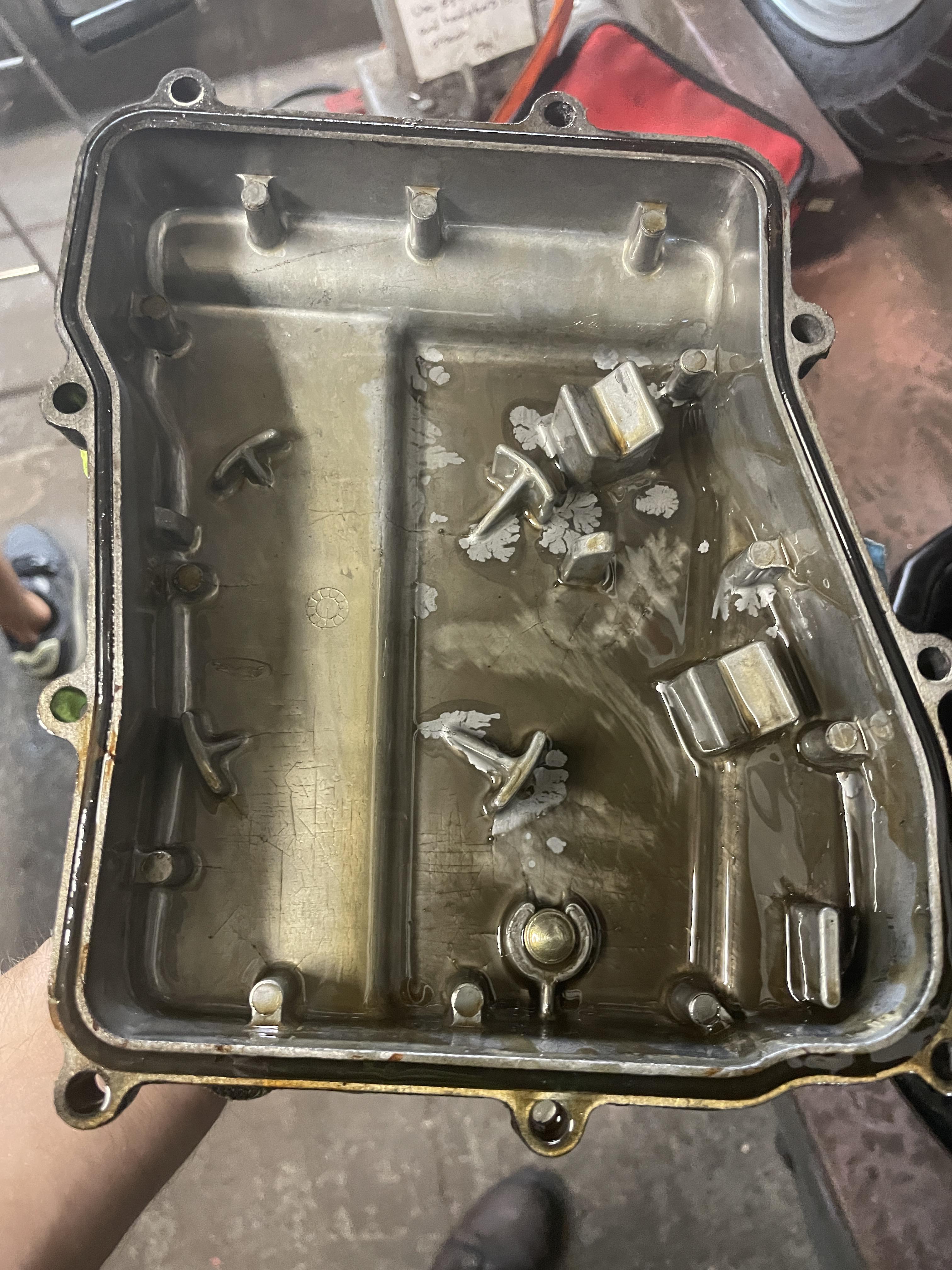

All back together, and the oil pan looked pretty darn clean.
It is not fun getting at some of those tighter spots like the rear header exhaust clamps, but there’s a certain angle where almost everything works.
I can’t for the life of me get the left hanger on the collector to line up with the thread on the engine, but it’s so secure right now that jacking the collector up moves the entire bike.
If I ever have to pull it again I’ll try addressing it differently, but for now I’m leaving well enough alone.

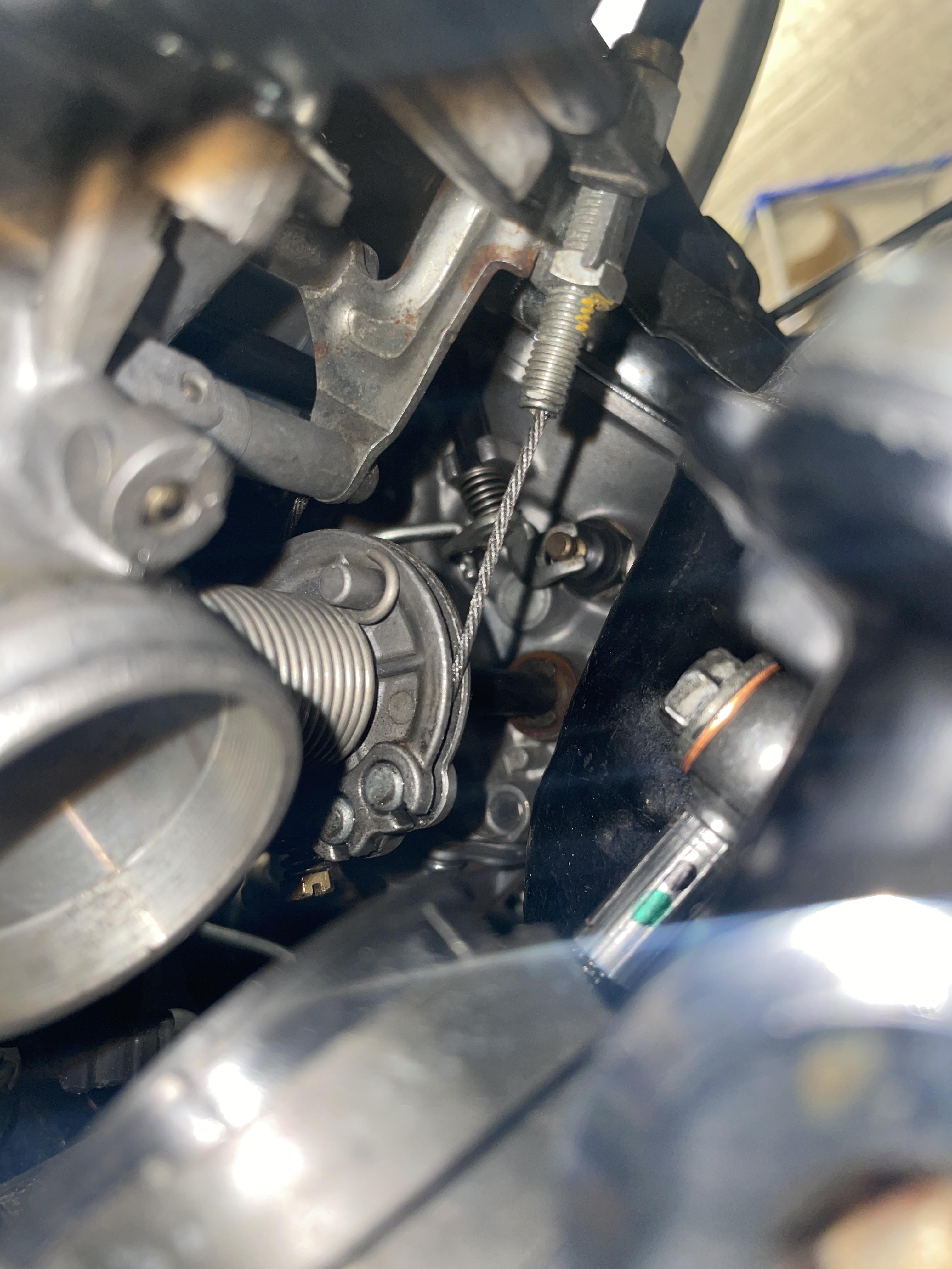

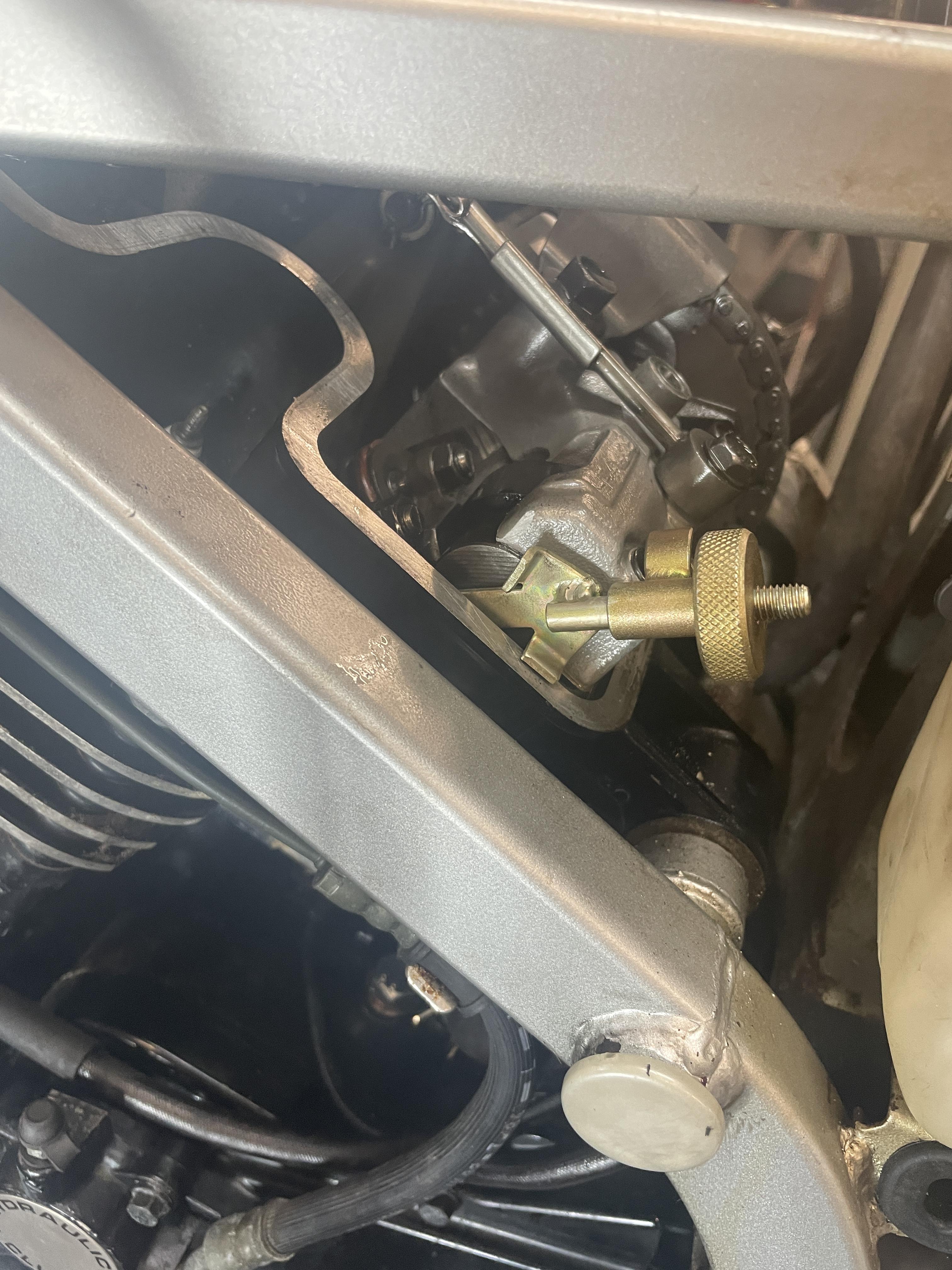

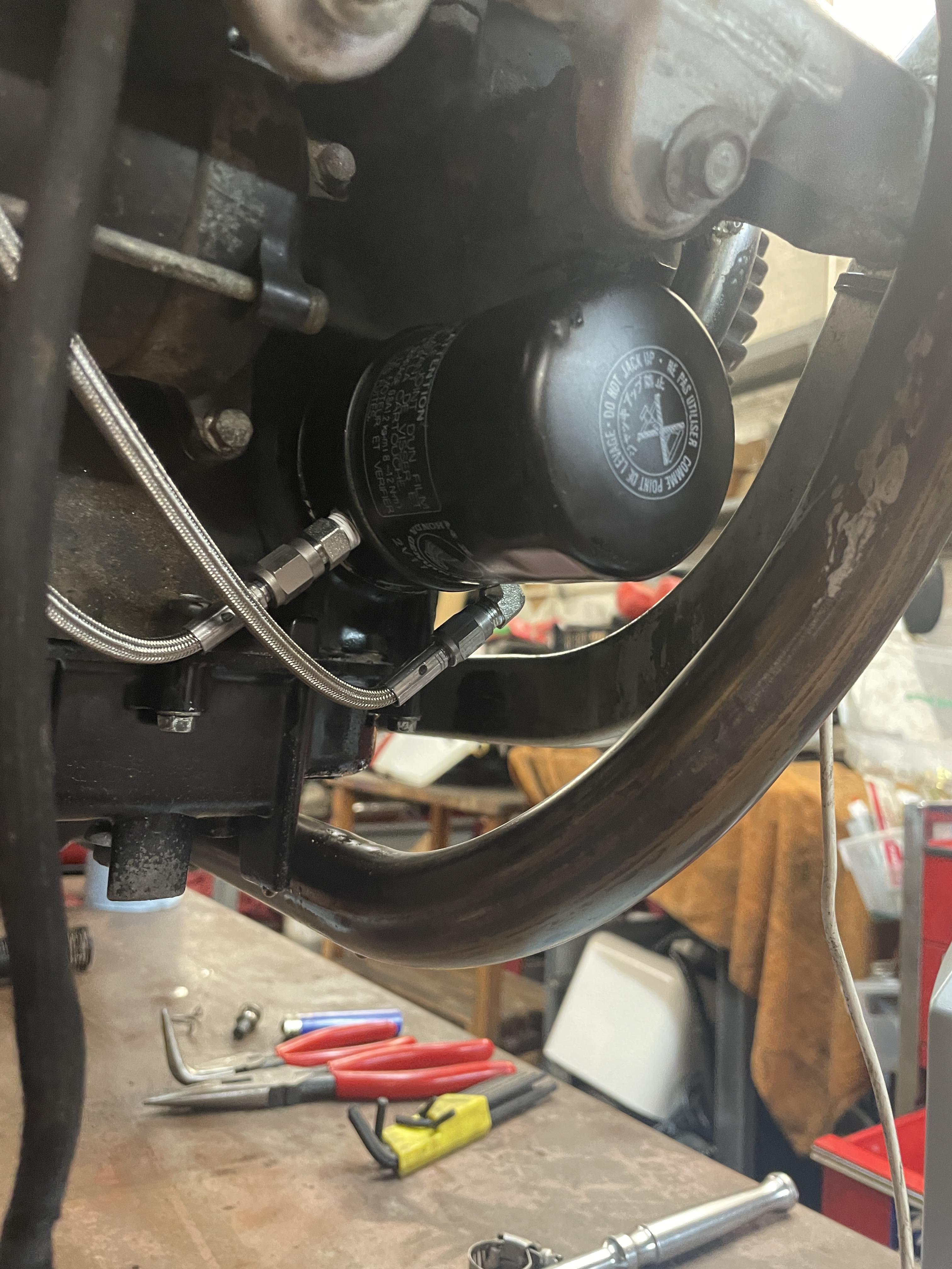

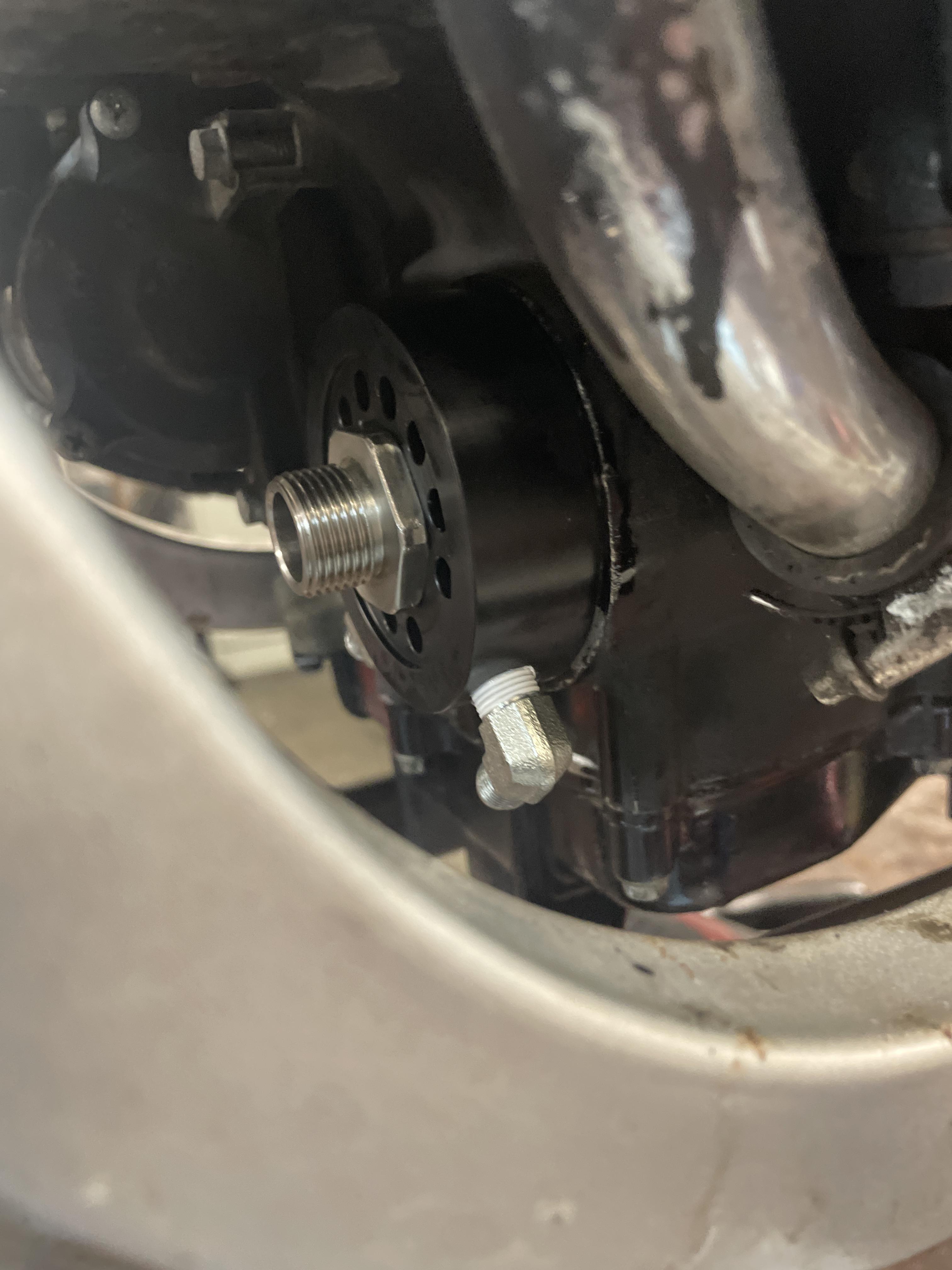

Productive day today - got the oil mod installed, hopeful that this will keep the cams running for a very long time:
Trying to figure out why the throttle isn’t returning when the bars are all the way to the right. Maybe it’s just some adjustments, who knows.
Also waiting on a new battery - the piece of junk mightymax battery puked up a bunch of acid even though it’s sealed, and now won’t take a charge, and is sitting at 9V so adjusting the valves becomes a pain - usually I just blip the starter to get the cam moving. The gasket on the alternator is fussy so I’d prefer not to remove it.
I’m assuming the dead battery is what’s causing this:
https://vimeo.com/753100355

Yep, not enough amps to fully engage the solenoid. Interesting oil mod, I somehow thought it was some internal adjustment made but it's an add-on product. Couldn't quite tell where the lines went though.
They intercept where the old ones were, but they come directly off the filter (discharge side of the pump), instead of passing through the same passageways the transmission gets it’s oil from.
Cuts out a bunch of pipe and brings everything direct to the heads. More than enough folks with old interceptors have done it to make me comfortable that I’m not stealing oil from the transmission.

Cool, sounds like a good idea and the transmission shafts are typically ball and roller/needle bearings so they'd survive more easily
Yup! Hardest part was getting the carbs back in after pulling them to get the banjo in on the front cylinder head.

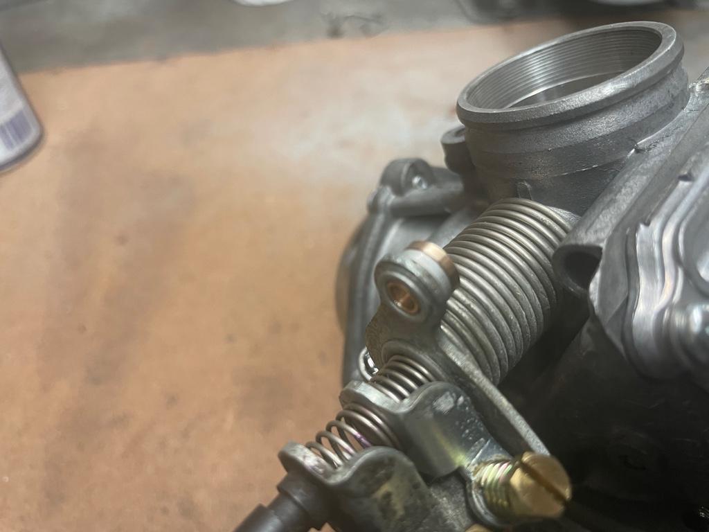

What I can’t figure out, is why whenever I let the bike sit for a bit, fuel pours out of the carburetors but eventually stops.
It’s got all of the trappings of a stuck float, but it’s coming from higher than the overflow port - though there’s a dribble coming from there, too.
Could be the fuel tube o-rings, or it could be the carb gaskets.
Unfortunately it looks like the carbs will be coming out *again* to get this sorted.
Really hoping it’s a quick easy fix once everything is apart - I’d love to get some riding time in on the interceptor before it gets too cold up here.
And of course when I’m setup to record and have lighting to try and spot the leak - nothing.
O rings or gaskets must’ve sealed up from having fuel in them.

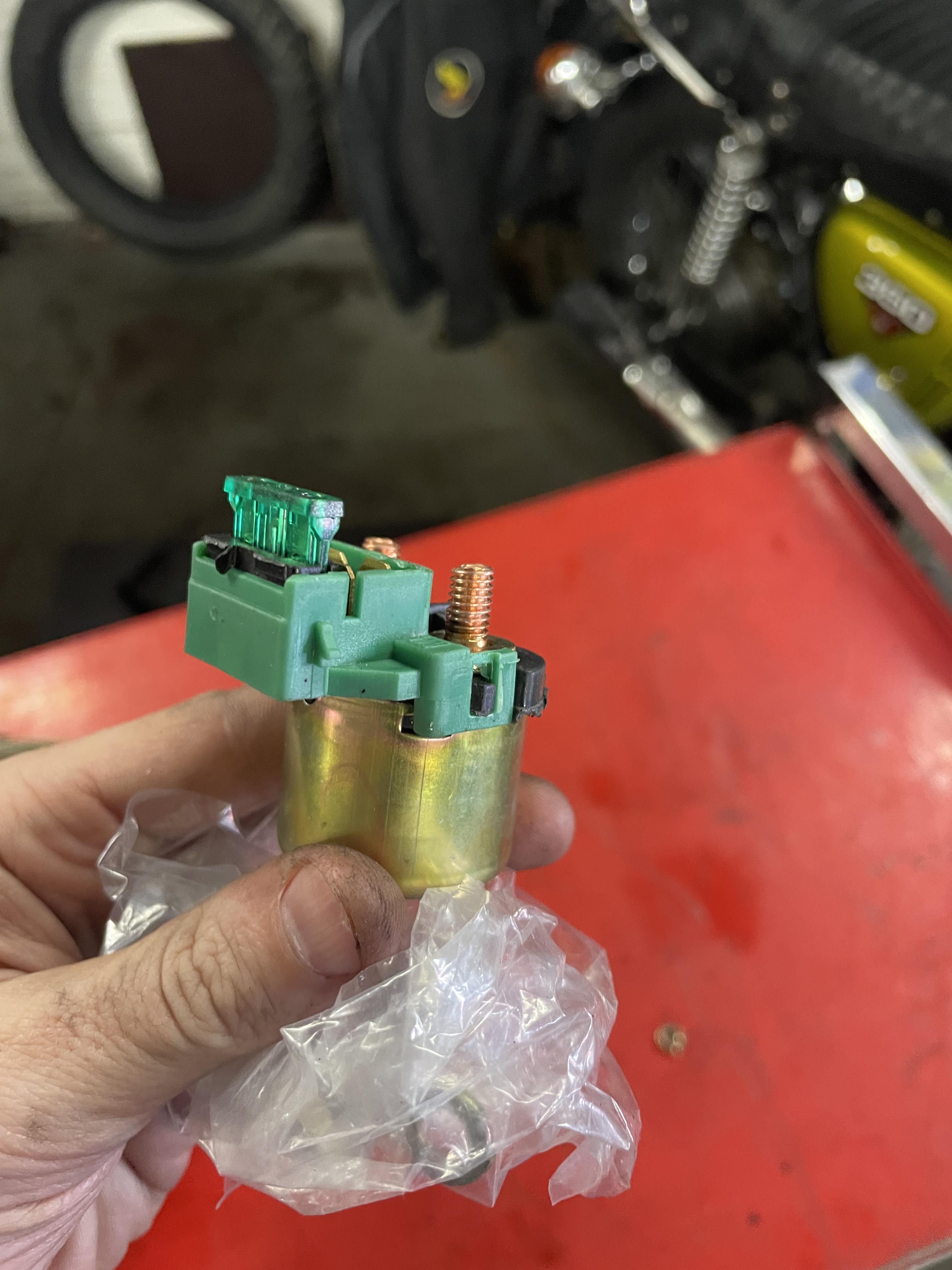

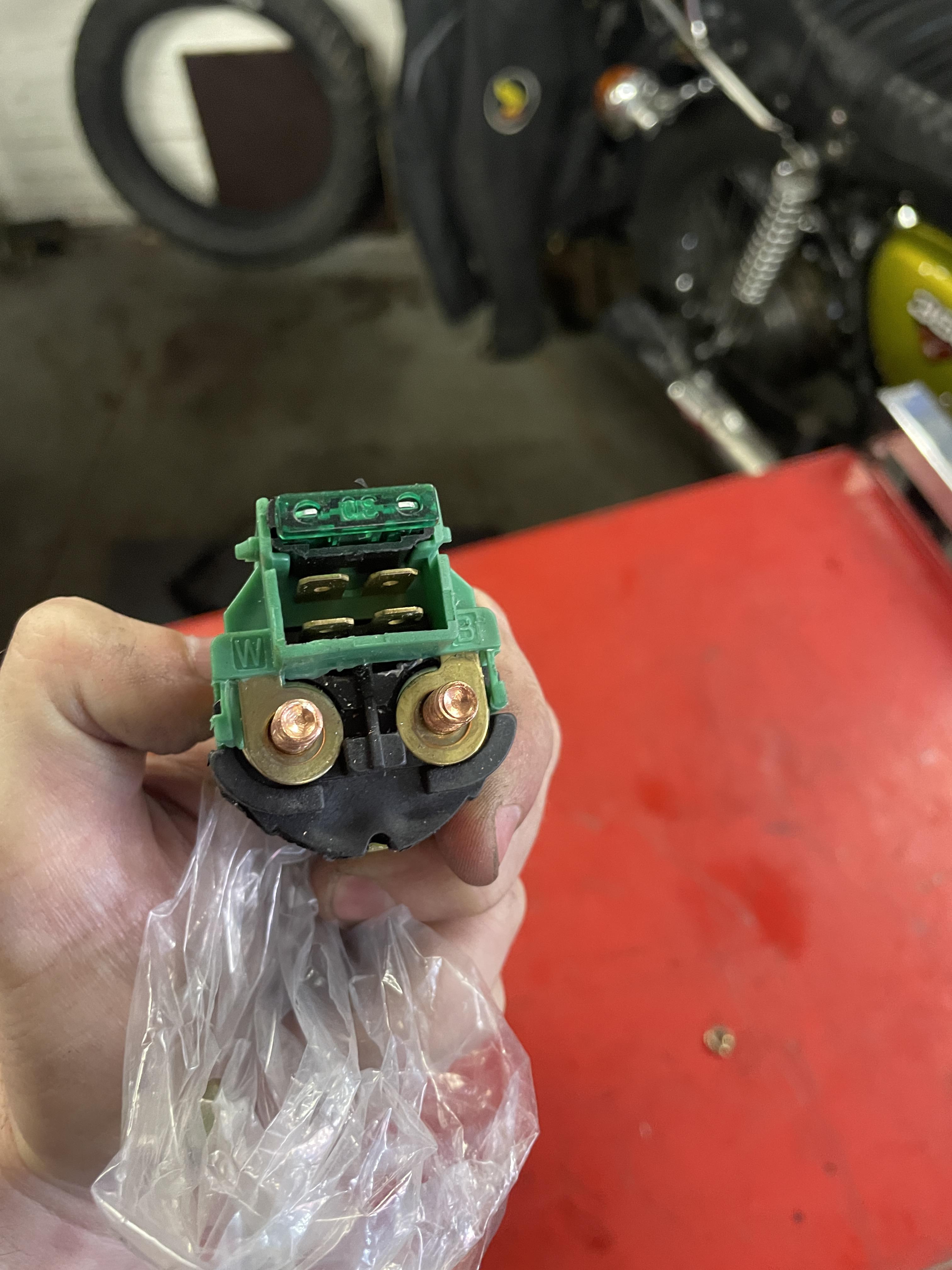

I did get the starter relay replaced tonight, so all wasn’t in vain.
The OEM one had a fusible link that’s tough to come by out in the world, so I had rigged up a standard in-line fuse holder to some wires crimped to the terminals… it was… functional but not beautiful.
The caltric replacement has a modern in-line fuse built into it. And is much cleaner.

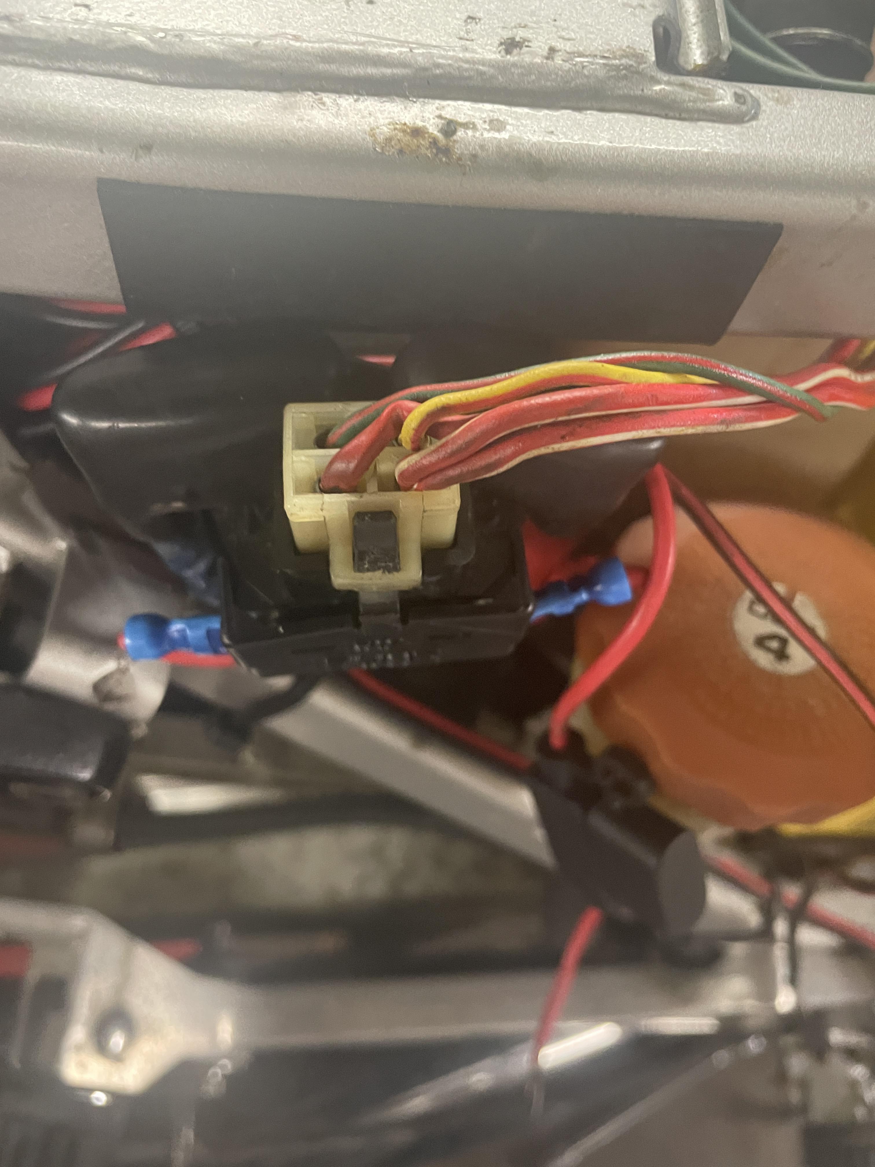

I feel you on the fuse, albeit a different cause. This li’l guy:
Popped on me because of a crappy override switch that dead shorted the battery to ground whenever the circuit closed from the radiator thermo-switch if the switch was in the “off” position. Poor design.
Normally wouldn’t be a problem *if* this were a 30A auto fuse (I forget the acronym) but good luck finding this old piece anywhere. Glad to have a regular fuse there now (and not Jerry-rigged)
Thankfully the seat covers the top of the side fairing where this relay/fuse combo sits. I suppose if this VF makes it to Germany I’ll miss out on the authentic pushed-by-German-police experience ^_^
