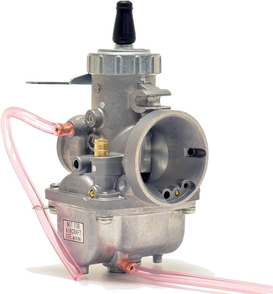

i have a 1979 honda cm400a that i’ve been rebuilding for about a year now. my main issue is that it’s all crank, no turn over. brand new battery, ignition coil, valve seals + engine gaskets + timing adjusted … but i believe my problem lies in the vm28 mikunis i installed. i have to set the idle screw to extremely rich, and even then it will only turn over on choke after about a minute of cranking. and if it is idling, any gas kills it instantly. i have no access to the oem carbs anymore (they were unsalvageable anyways) and i’m at a loss. yes, they have been cleaned and thoroughly inspected. are the mikunis a mistake? my friend threw an amazon carb in his ‘88 sportster and it runs like a dream, considering doing that …
How was the initial setup of the carburetors determined?
  • Specifically for the 400A?
  • A generic vm28 kit?
The idle adjusting screw is used to raise/lower the stop position for the slide. There is another [air] screw to adjust the idle mixture. The slide cutaway, needle profile, and needle clip all affect performance just as the pilot and main jets do. It can that a lot of tinkering to get to a good setup from a generic kit.
thank you for the diagram. i haven’t taken the carbs apart and really messed around with the jets, but i bought them as a kit from a “cafe racer parts” website and were advertised as plug and play. i was told that everything was already adjusted to where it needed to be based on my altitude and bike specs, but my bike doesn’t really like turning over. hahah. i’m not very familiar with adjusting jets, and i don’t know where they should be set. any advice?
I'm sure these carbs can be made to function correctly but they will require a lot of trial and error. Don't bother wasting money on the cheap Amazon carbs, your A model is rather finicky about the carbs. Moreso than the manual versions.
I'm not knowledgeable about the Mikuni's so I'll watch and learn.
In the meantime you might do a eBay search for the original VB24 carbs and save the search so you're notified when any get posted.
It can't hurt to download and read this tuning manual produced by Mikuni. It would also be helpful if you could report back on what components are in your carbs, especially the pilot and main jets. Everything should be labeled in tiny markings on the part itself.
If you haven't adjusted the air screws, you can gently turn one in until it just seats, counting the number of turns as you go. Here, 360 degrees counts as 1 turn. Then return it to that same position.
As for the idle screw, I would try to set it at the point where it just starts to lift the slide. If you back the screw almost all the way out and then start turning it back in, you should be able to feel when it starts to lift the slide. It will be slightly harder to turn as it pushes against the spring and weight of the slide.
When you crank the motor to start, have you given any throttle at the same time or no throttle at all? Have you tried with and without the starter plunger being depressed (same purpose as a choke, but not a choke)?

the kit came with new intake manifold boots but the boots to the airbox are stock. i had to 3d print some adapters/reducers to correctly fit the carbs in the boots without any gaps.

oh yes haha, i have been using the choke everytime i start the bike. what i mean by the throttle is that pinning it open allows enough gas to get the bike started, and i can release it and *sometimes* it’ll idle. by sometimes i mean it only idled by itself once. if i tried to give it gas while it was idling it died instantly. i’m pretty sure it’s just getting way too much air, but i can’t locate the source of where and why it’s happening.
There's no harm in trying to start it without the choke. You could try to open the throttle a little bit while cranking to see if it will catch and possibly hold the throttle to keep it running if it does start. This could provide more information for further testing.
Carb tuning is a process of trial and error and, as such, the carbs will likely need to come off and go back on a few times along the way. If you're able to remove and install them, it would be helpful to know how they are currently setup. That will give a base point from which to suggest changes. At the least, you want to have the idle screws and air screws in a good starting position. It would also be good to document the needle clip position, main jet, and pilot jet.
Is there a reason you suspect it's getting too much air? The mixture won't burn if it's too rich or too lean, so I couldn't say without more information. Trying without the choke would mean trying with less fuel and that could tell you something, one way or the other. Have you skimmed over that tuning manual?
Can we back up a second? Were these carbs take-offs from another model? For instance, the Yamaha RD400’s are 28 Mikunis but they used a crossover tube for the enrichener so unless that tube is there, the enrichener won’t work properly, the bike will always be in a lean condition. I suggest the RD as that’s a good set of carbs to use in a 4-stroke application.
In general, the Mikuni design is adjustable for every throttle position so that is no issue - but likely it’s jetted wrong for that engine in today’s configuration.

Glad you tossed the Mikuni's, very doubtful they could ever be made to work with the A model.
The A model uses VB24 carbs(28mm venturi) along with a different head that has smaller intake runners. Going to larger carbs will create unsolvable problems. 1st being the there will be a lip between the carb and the head where fuel will accumulate and puddle causing dead/flat spots and stalling, the intake runner from the carb to valve has to have smooth transitions the entire way.
