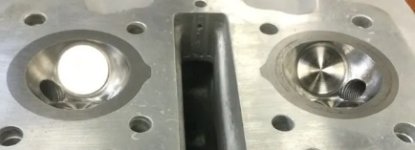

Lets discuss these Honda heads. An interesting design considered a "skull" type which was a hold over from the Honda racing department. Not at all sure why this was a thing but then we are talking early times during some very rapid growth and has been mentioned on this forum, metallurgy wasn't what it is today. After looking at it, I find that Skull is an excellent word to help describe this design. Notice that the predominant aluminum of the head, that is the part we see and touch, is cast around an iron chunk or Skull. Perhaps back in the day people thought that aly would melt under the combustion of high compression? (of the time that is) As a side gift, there was no need for additional valve seats! Any way, most of us will never see an issue from this unless the skull shifts inside the aluminum part. To my knowledge the only tell tail of this is a constant seepage of oil from around the spark plugs. And even then, the bike should continue without a hiccup as no part of the combustion is getting out. Because there is a lot of oil up in the cavity between the iron skull and the rest of the aluminum forming the head, the void for the camshaft, rockers, valves etc., of this oil can find a way out, wouldn't you? Consequently the oil can sneak out from between the aluminum an at the spark plug hole area of the skull cap.
In this picture below, the color difference seen at the combustion chamber, where the valves live, is from aluminum to the cast iron of the skull.
Next topic here is that one of the valves was at an odd angle in the head. Yup. the valve guide was not "straight". Best I can do to describe this is that the guide was not perpendicular to the spring seat cut into the head. Not sure why this was but it was fixed during the rebuild. Before we get all "how could that possibly still work", well, since the valve seat is cut using the valve guide as a, um, guide, suddenly the engine is all happy like. On an engine like this do I know if you'd ever notice a difference in power if any with one "canted valve"? Nope, and don't forget, this was not a huge thing (like a valve laying over at 20deg or some such) but could just be seen when looking critically and comparing the valve stems, springs removed, to each other. It was clear its brother did not line up!
Once valve guide areas were made right, new guides were installed and I was delighted to see some length to these as the last ones I replace were early Ducati bits. Those Ducati ones look more like a mistake from a lathe. In all fairness, again, I've no doubt Ducati had great reason to have such short little things. Those too were easy to replace so really, no worries. FYI, long valve guides wear better and a typically greater life. Then valve height checked, valve seats cut to order, installed springs for a height check, then and shimmed accordingly. Finally we were off to the races. Well, maybe just not yet.
Tim prefers to use a coating on the pistons, combustion chamber and valve heads. You've seen this copper looking stuff on the pistons already, but now the head was prepped and the coating applied. Don't ask me about it but again, Tim uses it all the time and has had great luck.
