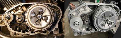

Since the engine was taken all the way down there'd be, of course, lots of cleaning. And not just solvents, sonic cleaning, vapor blasting but I also mean cleaning / reaming / drilling out all the oil passages throughout the engine. I emphasize this because as cool as the engine's oil system was for the day, too much trash ended up stuck in the crank. The crank too is a centrifuge but because there was no actual oil filter, as we know them today, lots of stuff could still move through the engine getting stuck were it could.
Look at these pictures. Sorry I don't have more because this junk here came out of only part of the crankshaft. Not all of the crank, just the couple parts shown. It takes aggression to get some of this out, thus, the drill. And by the way, look at the drill bit itself not to mention that RT side shows a pick pulling more solids out of a trough in one of the crank's cheeks. Both FULL of junk.
Continuing this discussion, I chose to remove the OE centrifugal filtering system off the bike and replace it with the Cappellini offering. There's no doubt that the centrifugal system is an intriguing and workable option but, my world was spent in the racing engine world and no matter where I looked, I never saw someone back fitting a centrifugal system for greater protection which doesn't disregard the potential of the type but more importantly to me points to the faith these racing engine builders place in modern filter systems. And with that said, part of my own decision of moving to the Cappellini cartridge filter system also came down to this. A) I'm lazy. B) Saw early on that even though there is touchable access to the centrifugal filter container through the Left hand side cover, you couldn't remove it to clean without taking off the entire side cover. Final bit was that the filter is not some special thing only available through Capellini but an over the counter part from Suzuki and many online resources. Done.
Installation is easy enough and when done, the oil filtering system looks eerily the same as it did. The only obvious thing missing is the chain that drives the centrifugal container. I'm also big on the kiss principle. Removing parts certainly fits that bill right?
And yes, both pictures are of the same engine. We will ignore that the light is sketch on the left picture but no pun....you get the picture!

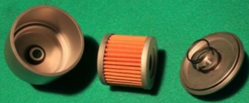

Believe it or not, the centrifugal filter canister is only slightly too big to remove from the inspection hole. Might be that the chain would stop it too but I never got that far.
Essence of the Cappellini cartridge filter system.
