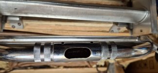

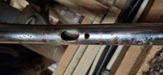

It would be nice to tidy the switchgear so that the wires run inside the handlebars as on the original. I’ll see how difficult that would be when I fix the tachometer. If someone would post a photo of where the entry and exit holes go on the original ‘bars that would be much appreciated.

These are SL/ CL 175 bars, but the entry and exit holes are the same. From memory, the locating peg holes are 3mm. At the bar centre, those two 3mm 'holes' are not used, just some ting left over from when bars were made up.
Edit: The locating peg holes are outboard of the main wiring hole.
Clutch side
Throttle side
Thank you very much, that should be all I need to route the wires correctly.
