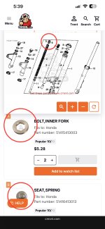

The nut I believe sets the preload of the main spring. Possibly a spacer of some sort will help, comparison to the other fork might reveal sizing needed
No, I don't know the size/pitch@LongDistanceRider - Thank you for the input. I have both forks dismantled currently, both missing the nuts and seal washers. Do you know if that special nut is the same thread sizing as the top nut of the forks? I'm assuming it matches that and threads down to the end of the top threading I saw inside the tube. But I haven't examined it closely either.
