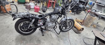

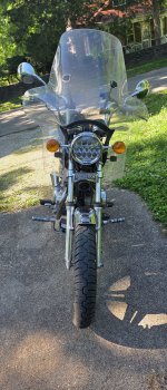

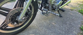

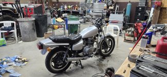

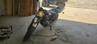

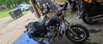

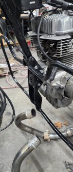

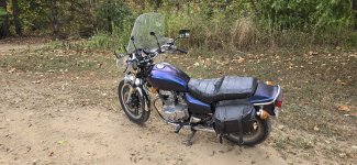

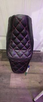

I've had this bike since 2011-2012. When I first got it, it had been wrecked and I knew almost nothing about fixing or working on bikes. Ibwas able to get it running and enjoyed it a few times the over the summer of 2013 then it sat in a garage until last summer where I finally found time to see what I could manage to do. Since then its gone through some changes mostly restoring it as close to what it was originally as I can. So here are some pictures. Top to bottom in order from first start to complete bike and all the variations in between.one of the biggest headaches i had was finding an original seat in halfway good condition. I ended buying an old seat and hand stitching (with needle and thread, no machine) a new seat cover. So anyway tell me what you all think. 838.jpg839.jpg840.jpg481.jpg477.jpg520.jpg1195.jpg1199.jpg
Nice work. The stitching on the seat turned out well and the black paint job did, too, although I also liked that chameleon-like paint in one of the middle pictures.
Are the low LED lights to see or to be seen? I could imagine them being helpful on dark country roads.

The lower lights are more to see at night, it runs pretty well but I still think I need to do some more tuning.

What headlight is that? And does it fit in the original housing? Nice job!
Larry
I found it on Amazon it said it would fit my bike but when I got it it was in a thick plastic housing and didnt fit quite right. Had to shave the plastic down in a few spots to get it to fit right. When I looked at the instructions it said it was meant for a jeep lol.
That is pretty funny. The light provided is an improvement though right? Would like better light and lower power consumption. Thanks for letting me know.

Is the front wheel centered ? ..Looks left
Is the front wheel's axle holder installed correctly with the arrow in its casting pointing forward ?
