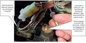

Hi all! I'm starting on this project bike and found some issued already (bad starter solenoid). Additionally the bike was already worked on and some things were disconnected so I don't have a good point of reference. I'd like to make sure I get this part right when the new part comes in: What connects to the starter solenoid?
I looked at the wiring diagrams and here's what I see:
Looks like blue/red should have a another wire with a connector that terminates it to the solenoid...right?
Positive from battery to solenoid
Starter switch from the solenoid to the switch (yellow/red and green/purple)
Starter motor positive to the other terminal on the solenoid. (blue/red?...)
Ignition positive to battery? or to the same pole as the battery to solenoid?...does it matter?
