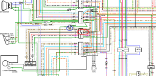

I’m going to settle down with a circuit diagram, but in the meantime, on the off chance 🙄😊 hoping someone might shed light on the wire.

Looking at the wiring diagram, I guess as the yellow/black at the handlebars comes from the fuse, I should get 12 volts between that and earth.
Then that leaves via either the blue or white to the headlight and I should get 12 volts on either depending on switch position.

Jim/Pete, I see the red/black goes to starter button as alluded by Jim, sorry. As bike cranks, I was hoping not to pull that switch apart, but hope that there is access to get to red/black to circuit test.

I understand and I might be wrong, but the other side of the starter button is red/yellow? I put my meter black lead on battery negative and red lead on the red/yellow at the starter relay and still red 0.6 volts. As mentioned I may be going off piste.
One of your switches may not be switching the battery voltage correctly or is intermittent.
I would go to the black wire on the horn if you have battery voltage there with the ignition on then your ignition switch is passing the voltage to the black wire
Then for the headlight and starter the black wire goes to the right handlebar switch and passes voltage base on the starter push button, button not pushed should send voltage to fuse through Black/Red and leaves the fuse as Black/Yellow
if your push button is dirty or broken then it might not be passing the voltage correctly even in the not pushed position.

That may be the right model but the button logic for the Starter button is not what mine says
Bat2 in the incoming voltage on the black wire and it is applying the power to either the Starter solenoid or the Headlight circuit.
In the other diagram you can't cross the black/red and the yellow/red
