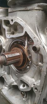

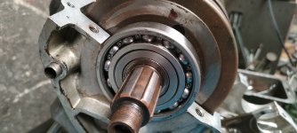

The pics tell it all, but the bearing is an SKF 75x45x16, C3

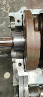

I turned up a bush to slid over the crank journal and fit the inside of the bearing.

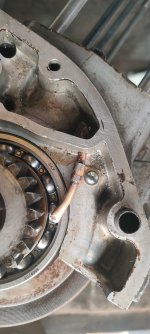

I'm toying with feeding a little extra oil to the ball bearing for cooling? But then my Yamaha 250 has smaller ball bearing mains and is lubricated by splash.
Any opinions or improvement suggestions welcome!
