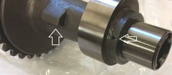

Hi everyone,
I am working on a CB450K4 and run into a bit of a puzzle regarding the camshaft timing. According to many general resources, there should be clear timing lines on the camshafts. However, on my shafts, I cannot find any lines at all—only punched dots (as seen in the attached pictures).

Since this forum is known for its deep expertise on these vintage twins, I wanted to ask here for a more definitive answer: Are these punched dots indeed the official timing marks on certain production runs of these camshafts, or should I keep hunting for hidden lines?
Any insights or validation from someone who has run into these same dot-marked shafts during a rebuild would be greatly appreciated.

I'm not completely sure if they are original, obviously I haven't seen every version of 450 camshaft but the majority of cams I've seen do not have those marks. I traded a pair of used high performance cams done by Megacycle in 1992 for my build and they have dots for cam timing instead of horizontal marks.
I'm not sure if Megacycle made those during the regrind process but it would make sense, since they've been regrinding and refurbishing 450 cams since the late '60s and have refurbished thousands of cams for the 450 alone over that time.
Full pictures of your camshafts that show the timing dots, as well as the castings near them, would help determine if they are marked in the same location on the camshafts as mine are.

Can you tell us which cam is which in your pictures? Top is exhaust and bottom is intake?
Based on the castings visible I'm guessing that is correct. I'd like to see full sized pics of each cam, 180° apart, so we can see the castings and where the dots are in relation to them, to compare with mine further.
Thanks Rob. And the dot is on the exhaust cam, which makes me wonder if it had been refurbished by Megacycle too since the exhaust cams are the usual victims of lobe and follower wear.

You don't happen to have any full pictures of the cams before installation, do you? Ones that show the castings and timing marks in the same pics?
I found this pic of my repaired exhaust cam after getting it back from Megacycle, note the casting facing outward when both the dot and original timing mark showing.
I don't think the little "dot" showing in the top picture provided by the original poster is a timing mark for the exhaust cam. It doesn't seem to match up with mine, shown below.
The one in the second picture does appear to be a timing mark for the intake cam.
I don't think the little "dot" showing in the top picture provided by the original poster is a timing mar for the exhaust cam. It doesn't seem to match up with mine, shown below.
After a second look I agree, the tapered area of the casting is about 90° from that "dot". That camshaft might have a faint line where the mark actually is, which is why we need more full-sized pics of both cams to be sure.
