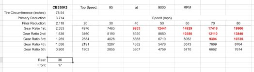

When I built my CB350 I was thinking it would mostly see city use and used 38T/15T sprockets — 60 mph in fifth gear is about 6800 rpm.
Here's what things look like with 36T/17T. It would make the bike slower, but perhaps a better commuter.
You can go to the gearing commander site to play around with things easily — choose the 350G.
