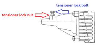

To be completely clear, this is the correct procedure:
First, position the crankshaft at 90° past LT on compression stroke, then loosen the tensioner lock nut, then loosen the tensioner lock bolt. The spring-loaded adjuster will tension the chain. Then, without moving the crankshaft, first tighten the tensioner lock bolt to secure the adjustment position, then tighten the tensioner lock nut to secure the tensioner lock bolt.
