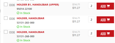

Are there two types of upper handlebar holders? I am talking about part number 95014-22100 from the handlebar section of the parts manual (page 40).
When I disassembled the bike, the upper holders had large washers that looked strange but I did not think much of it.
Later after polishing the top triple clamp (called 53230-246-010 BRIDGE, FORK TOP, sam page of manual) I noticed that a previous owner had drilled out the holders to a huge size and this explains the strange washers (see picture below).
Lokking more closely the holders were drille huge because they are the wrong part and this was the only way that the bolts would line up. I measured the bolts and they are M8 as they should be according to the parts manual.
So I purchased two new top holders. When they arrived the first thing I notice - they are identical to my drilled ones, the holes are way too small for M8 and they don't line up with the triple clamp. I am actually at the same point the previous owner was when he decided to drill them out. So are there two 'versions' of the top holders (95014-22100) out there? Can anyone shed any light on this? Thanks in advance.
That is bizarre. There are two different versions of the fork lowers, but I’m not aware of that extending to the triple or the bar clamps.
According to Partzilla there are actually 3 types of holders and 2 different top bridges.
The "283" holder was first used on the CB450K0 and the "268" holder on the CB72. Maybe one of the members with a CB450K0 or CB72 could measure the bolt spacing on their top bridge to confirm which one you need.
