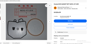

Thank you for the paint link that will be amazing for me, I will be updating on the carb in a few hours, Also okay, i suppose worse comes to worse i will have to repair trans after everything else but i guess that's not TOO bad,
Also would the dual piston caliper bolt right up? Where could i get one? I'm always more than happy to replace with a better part, I'm not having trouble with the crank moving but i likely need a better impact so i will pick one up today as well,
I also think I may have a tool for this, I have a moped flywheel puller and based off what the pullers look like for this bike, I'm like 80% sure the center bolt for my puller will work on this bike, I've heard of other options too that are typically in store compared to ordering such as a bolt that size, I will tell you guys now I have NO manual whatsoever, my only guides is google and here, Also I've been cleaning it very carefully, I cleaned it a bit yesterday I may clean it more.
Thank you for the part links everyone, I will be sending in-depth carb pics and bike pics later on today to help show what's going on more in depth

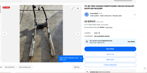

These are the exhaust pipes I mentioned I was looking at, they are a few dollars more than what someone linked in here but I need everything except the 2 front straight pipes. They look like they would bolt right on but I want to make sure

Okay I'm gonna order up the exhaust and side covers then, as for the rubber part for the center stand ill check for one on ebay, If not there I will be ordering one from honda, I was thinking of buying a ultrasonic cleaner, But I was wondering if I could get by with a chem-dip possibly though? A ultrasonic cleaner is pretty pricey, I can get one, just don't want to have to if there's something else you know? Also Okay thank you i will check PM's in just a second

I would see if and how the engine runs before buying that rusted exhaust assembly you linked from eBay.
Because what if your engine needs a partial disassembly and repair service for torque converter service or the ignition system's stator needs to be sent off for a rewinding or the CDI isn't usable, etc..?
Then, during that time you're doing the repair service(s) to the engine, carbs, and ignition system, other exhaust parts you need or which are nice and not rusted (in addition to the new aftermarket "power chamber" I linked above at SCI and those used but very nice, somewhat expensive $170 mufflers I also linked) may get listed by someone else on eBay.
May i ask what you mean exactly? i see your point on the rusted exhaust, THAT may not be worth it, the separate pieces are just very expensive on top of that i would need gaskets and etc correct? So I've been looking at complete sets, Also I plan to do a valve adjustment so it will have a partial disassembly for sure, But as of right now there's a lil over 150 compression in each cylinder, That may get better after the valve adjustment, Also the cdi and stator seem to be okay since I'm getting strong spark but you do have a point, what would you suggest i do to try it then without the carbs right now? I don't really want to have to use starter fluid if i can avoid it as to keep the motor in good condition, also i mean id have to agree there's a possibility i have to repair something in the trans for all i know, i did see above there's not really anyway to know and as of rn the best id be doing is letting it idle without a chain lol if i did try to get it to start, i believe it will it just will depend on ME and my skills to tune it once the carb is done and everything else is done
I meant to hold off on that rusted assembly with the dented mid power-chamber until you've serviced and installed your carbs rack, checked out and verified a properly working ignition system, and run the engine on the bike's center stand with a fan blowing on it for sufficient time to determine that the stator and CDI and your carbs rebuild service are good thru a high enough RPM to verify.
During the time from now until then you'd likely see less expensive and much less-rusty mufflers and dent-free power-chamber, or an assembly without headpipes since yours look plenty nice, nearly rust-free and shiny.
All 4 exhaust gaskets have to be bought new anyway since the one above is going to be dismantled for shipping. That eBay assembly above - the muffler ends aren't shown in the photos and could be drilled or rusted thru or even removed entirely which is not good for needed exhaust backpressure. Yes, it's got the chromed heatshields and muffler hanger plates, but those can be found individually or separately on eBay too.
Economical new pipe clamp set :
and Four-into-One also has the 4 exhaust gaskets you'll need new anyway since the eBay one above in Oregon would be dismantled for shipping to its buyer
That's what I was originally going to but I didnt want to run carbs without a proper exhaust as I heard it tends to make it run slightly bad, Im not sure tho thats what Ive heard is all
